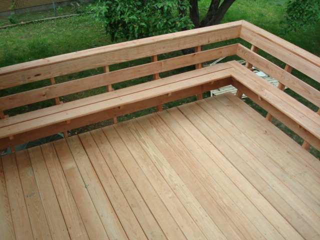

Marcel, Reading your lips had me looking further. I came across this article by WAGNER.
The myth of the Ladder Effect and other guardrail safety issues
Page 20…
Horizontal Bars
Not recommended
◦Subject to bending and stress, very unforgiving relative to cable rails
◦Use cable instead
I stand corrected. I beg your pardon.
I think Roy cuts to the heart of the matter here. I explain to people that I am not looking for code violations per se, rather conditions that impact the integrity of the structure, its systems or the safety of those using it/them.
I think it would be entirely appropriate for an inspector to cite a condition like this as a “Safety” issue, regardless of code.

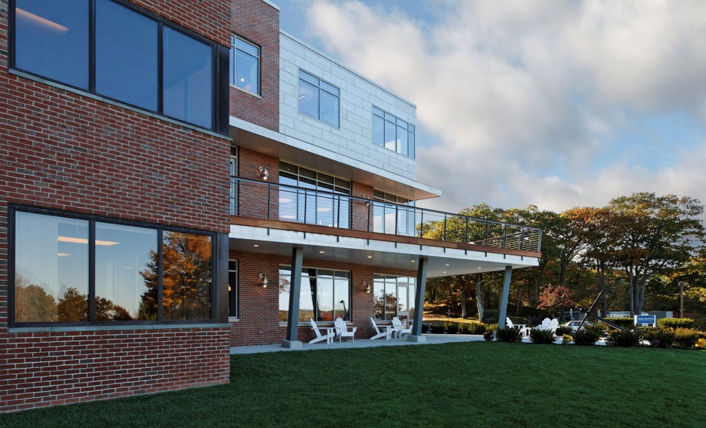

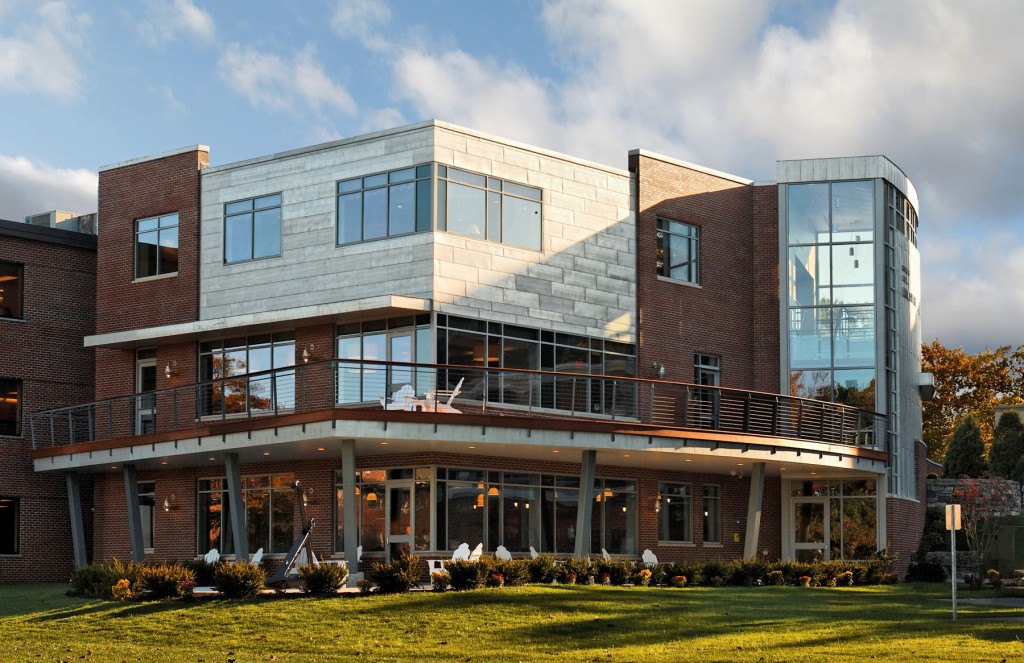

So this would be a safety hazard too then, right. ?
Barbra Bush Center we built a few years ago.
College Campus.
Architects did not call the railing a hazard here.
:):wink:
If you see something that you think would be beneficial for your clients to know you should certainly point it out.
