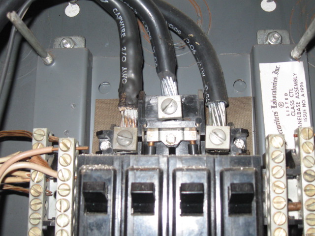

Each toggle of the mains was labeled 70. What is the total amps?
mgratton
(Marcel Gratton, CMI)
2
70 Amps., tie bar missing.
The conductor on the left in your first pic appears to be overheating…
rmeier2
(Robert Meier)
3
I say 140 amps. #2/0 Al for a single family dwelling is rated for 150 amps.
belliott
(Bob Elliott, 450.0002662)
4
The cloth conductors at top in second pic need attention.
