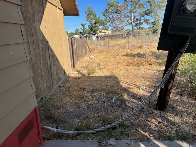

Hello,
The electric cable from the power pole to the manufactured house is currently above ground, which I believe poses a safety risk, especially for young children. Is it possible to bury this cable underground? If so, I will likely need to extend the cable. Could you inform me where I can purchase the necessary thick aluminum cover and the cables that fit inside, as well as how to properly make the connections? I am also concerned about water entering the pipe through the connections during rain. If there is another safer method, please let me know.
Additionally, the electric pole is leaning. Could you advise on how to straighten the pole?
Thank you.
IMG_4562
IMG_4563
Yes, those feeders should be buried underground, but not with that flex conduit. Thats not rated for burial, which means the conductors inside probably aren’t either. That is an amateur job that should be fixed. But I dont think anyone on this forum is going to tell you how to do it. That takes specialized knowledge and licensing, and the fact you are asking how to make the connections means you need to hire an electrician if you dont want to kill yourself.
If that is the meter, an electrician would also likely need to pull a permit, since they would need to cut the permit tag to gain access.

Or above ground with proper overhead clearance :wink:
That’s a job for a pro!
Thank you very much! I already found a pro.
Well, that depends on whether or not there is a disconnect at the meter… I cant tell from the photo.
Then you don’t need us, your pro should know what to do! Vaya con Dios
