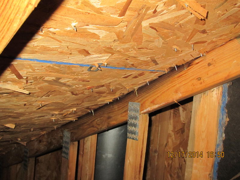

This photo was from a recent inspection.
It was taken from the attic. The top of the rafter and adjacent osb sheathing is discolored. The moisture meter indicated a 20% moisture content. When I moved the insulation below this area, I found a large area that was very wet (see second photo). This area was where a wood-framed “chimney” intersected the roof. Unfortunately, I was not able to access the roof on this particular day due to ice and snow. However, due to the signs discovered in the attic, I was able to inform the client that there was an active leak of the chimney flashing and it would need to be repaired.

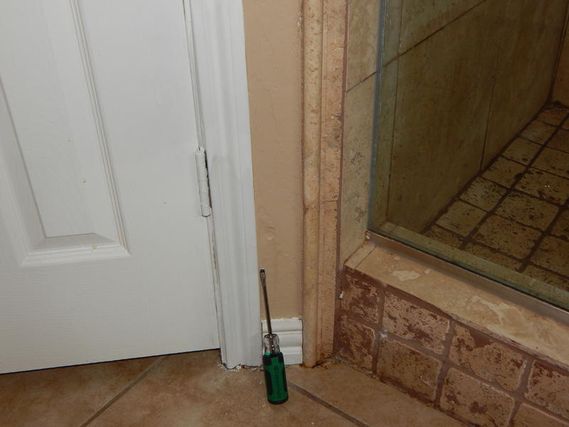

Water damage at the tub/tile/wall junction. The problem appears to have been ongoing for some time, and an attempt to repair the wall is evident. The floor tiles have come lose, the drywall is damaged, framing member(s) are potentially damaged, the shower door frame is not properly caulked, the tile grout is failing at the tub, and mildew is present.

Here is a picture of some moisture damage to a bathroom wall and flooring. It is hard to tell in the photo, but there was damage to the drywall that had been painted over and looked fine to the naked eye.
