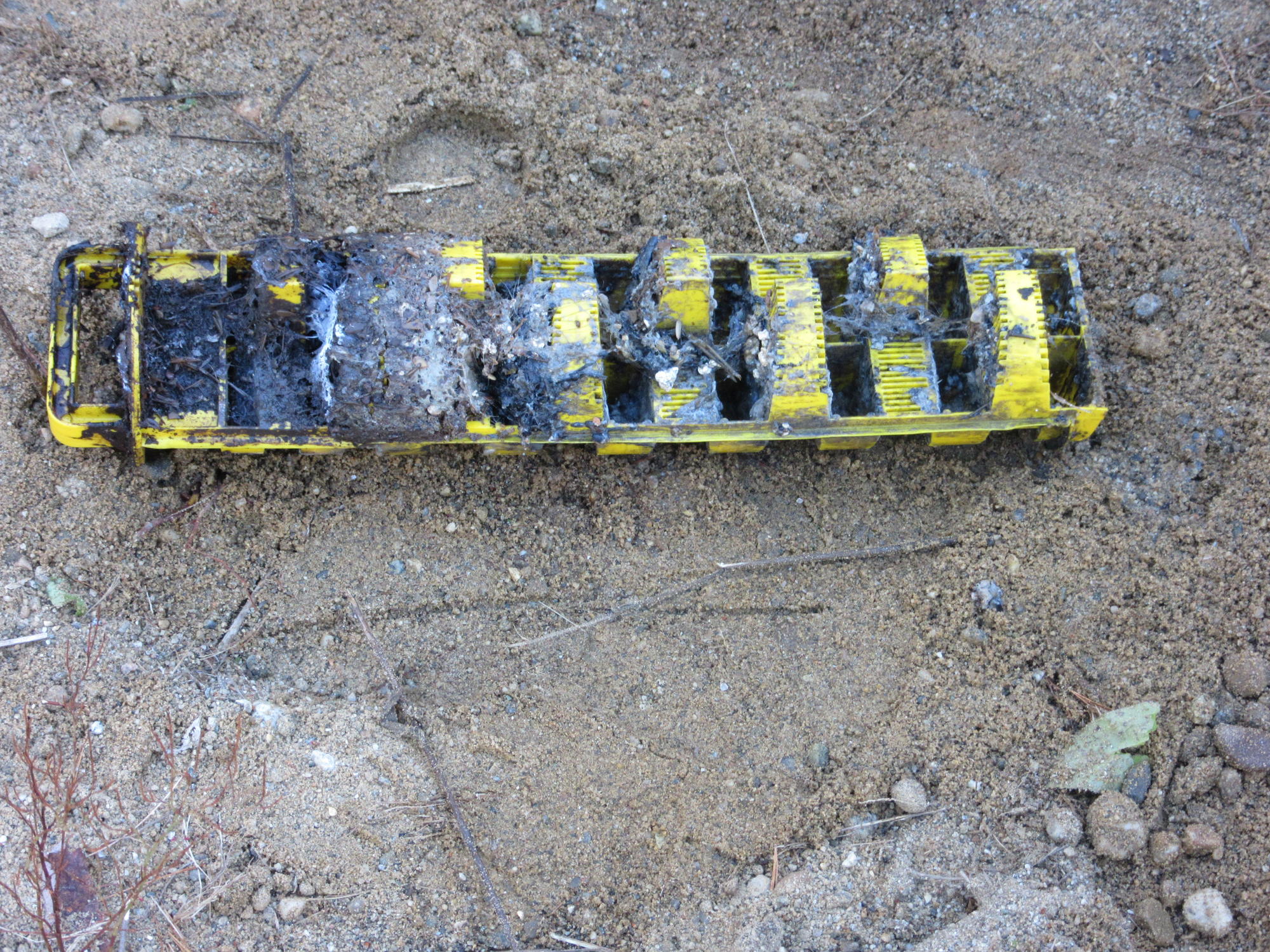

This was a 25yr old system. 1000 gallon concrete tank with gravity to a 20’x40’ stone bed. There were a few issues , but the one in the picture is the outlet baffle was deteriorated and had fallen to bottom of tank. I replaced outlet baffle with Extenda Lok and Poly outlet Tee and filter. Tank also showed signs of deterioration on underside of outlet cover and underside of tank roof itself.

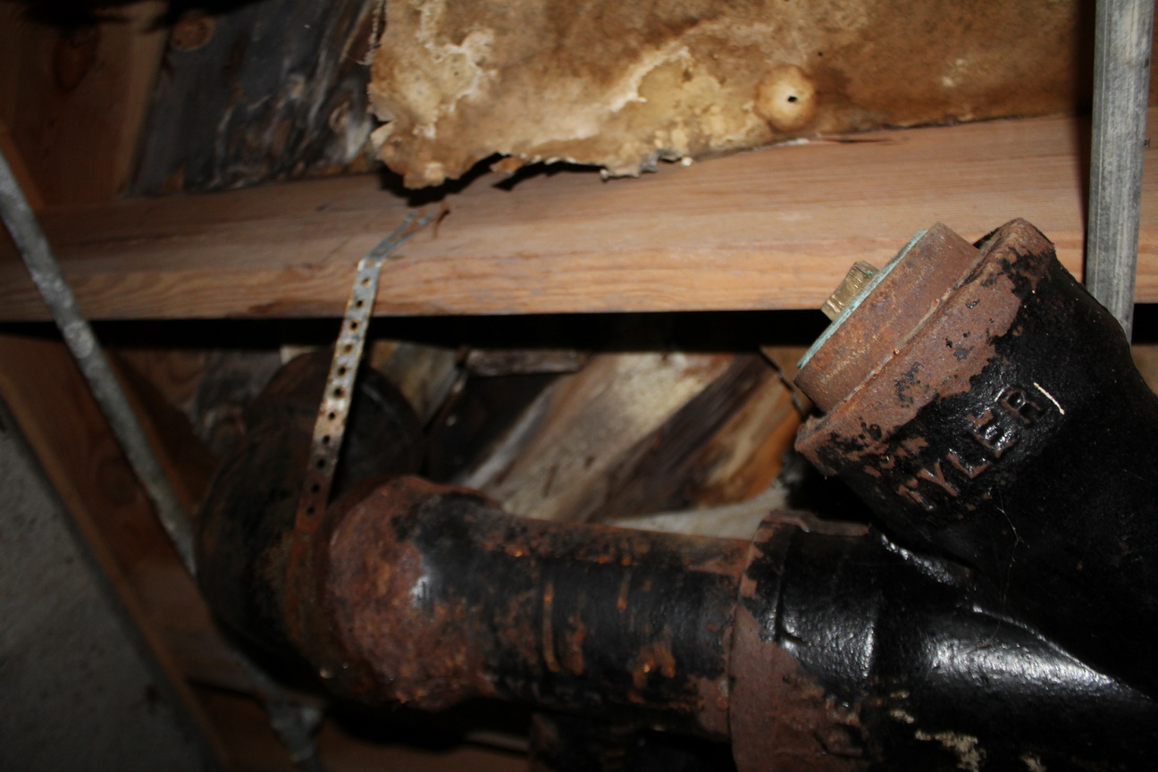

The attached photo is a section of the wast water system that feeds into the local septic system.
. This shows two waste water lines. The one on the left has a rubber coupling that is in good condition; the right line has a homemade coupling that is currently leaking and requires repair.
The cast iron waste water lines exit this residence and then attach to a septic tank approximately 11.5’ from the residence exterior wall. The local septic system appears to be in good working condition.

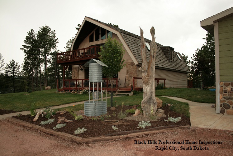

This older home built back in the early 70’s did not have a visible lid in order to have the tank inspected, pumped and certified. Now mandatory every 5 years.
This septic tank was buried 4’ feet underground and this system had never been pumped out. We tried to locate the tank and lid with a fiberoptic camera.
The fiber optic camera with a locater was off by 8’ and ended up locating the tank with two marking flags used as a water witch. The tank was within 6" inches using two wires for a water witch. Needless to say the guy did not charge me for the fiber optic service.
I never believed in water witching until that day. IT WORKS!
We dug up the dirt and located the tank, cleaned the dirt off the top of the tank and inspected the tank and lids. Inlet and outlet inspection covers are on each end. Had the tanked pumped out and inspected the baffles and replaced.
We added two 2’ risers to the tank with a lid at ground level so the system can be easily checked and serviced.
Finished product after digging up the yard.
I made a wishing well out of culvert pieces and the lid is under the wishing well, Just roll the wishing well out of the way and serviced the tank as needed.

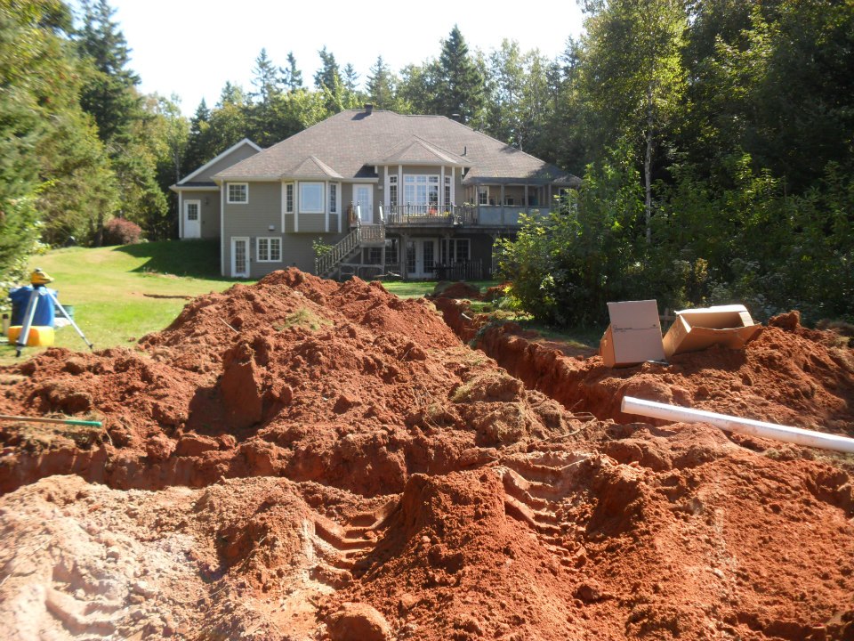

This picture was taken of a septic system being installed. It is important to glue all connections of a septic system. If you don’t, leakage can occur in unwanted areas which vegetation may possibly grow into. This will eventually clog your lines and cause a backup in the system which leads to expensive repairs.
