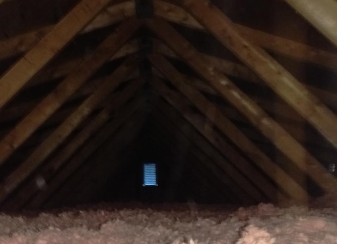

The attic in the image is a zone 6 home which requires an R – value of 49; however the loose fill fiberglass insulation is only 12 inches deep which means it has an R – value of 30 at the moment. It is recommended another 7.5 inches be added to save energy and meet the standards. There is no insulation covering the attic hatch and it is recommended that be changed immediately. Asphalt covered paper can be found underneath the insulation to protect the home from moisture. There is no sign of moisture damage in the attic. This attic is ventilated by weather protected gable louvers and the ventilation they provide is adequate for the attics size.

The home being inspected was located in Zone 3. Note that the rafters are 2" x 6" along with the framing for the ceiling. While loose insulation was noted to exist in the attic, it was deemed to be insufficient. Loose insulation measured an average of 6" in depth and was moderately compressed after being installed many years ago. It was recommended that insulation be added to increase the value to a minimum of R-30. Also noted was the existence of sheathing to provide a landing at the top of the access. Although not uncommon, the sheathing was applied directly to the framing which allows a maximum of 6 1/2" of space for insulation. It was noted that to reach a minimum R value of 30 that the distance between the landing sheathing and drywall for the ceiling be increased.
