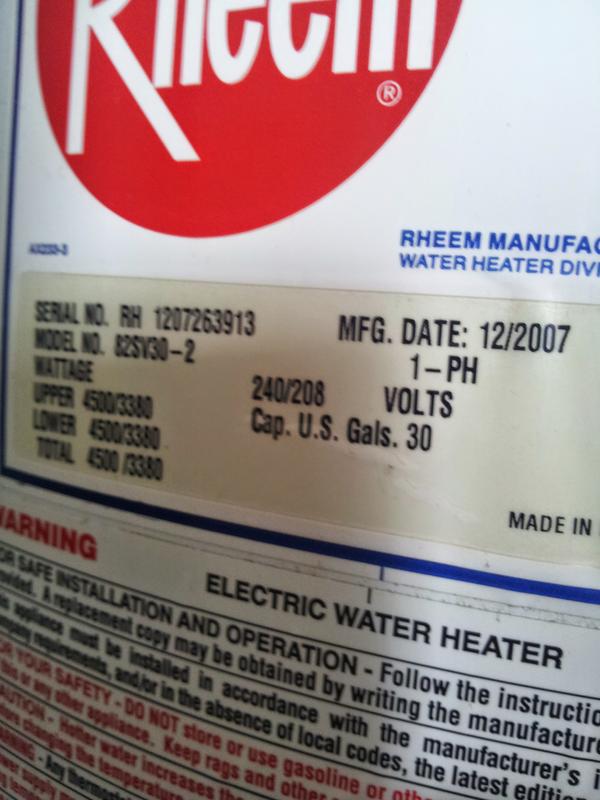

This is a photograph of a label from an electric water heater. Much information can be found on the manufacturers label. The labeling on the hot water tank could list the manufacturer, the tank size, the serial number, model number, fuel type, BTU ratings, and proper clearances required for the tank.
Water Heater Inspection Summary:
I inspected the water heating equipment, including the energy source,
and temperature/pressure-relief (TPR) valve.
-The water heater is an electric water heater powered by a 220 volt circuit.
-The unit is a REEM brand Model# B2SV30-2 manufactured in 2007.
-There are two heating elements for this unit
-This unit has a 30 gallon capacity
-There were no visible leaks at any valves or seals at the time of inspection.
-TPR valve appeared to be installed correctly and in good condition.
-TPR valve was not operated in this inspection.
-The drip tube is installed and directed into the catch pan.
-Catch pan was not drained into a drain, however there is a “Floodsafe” device installed and the water detector was located in the catch pan. Upon detecting water in the pan, the flood prevention device will automatically shutoff the water supply to the water tank.

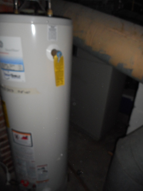

This 2002 Rheem gas water heater should be inspected by a professional liscenced plumber to determine what maintanence issues need addressing or if the appliance needs replacing.
A safety concern that does need immediate attention, seen in this photo, is the absence of a drip tube that should be attached to the TPR valve.
There is water marks , indicating there was a previous leak, along the side of the tank but at this time there is no indication that a water leak of any kind is occurring.
Missing TPR valve extension
