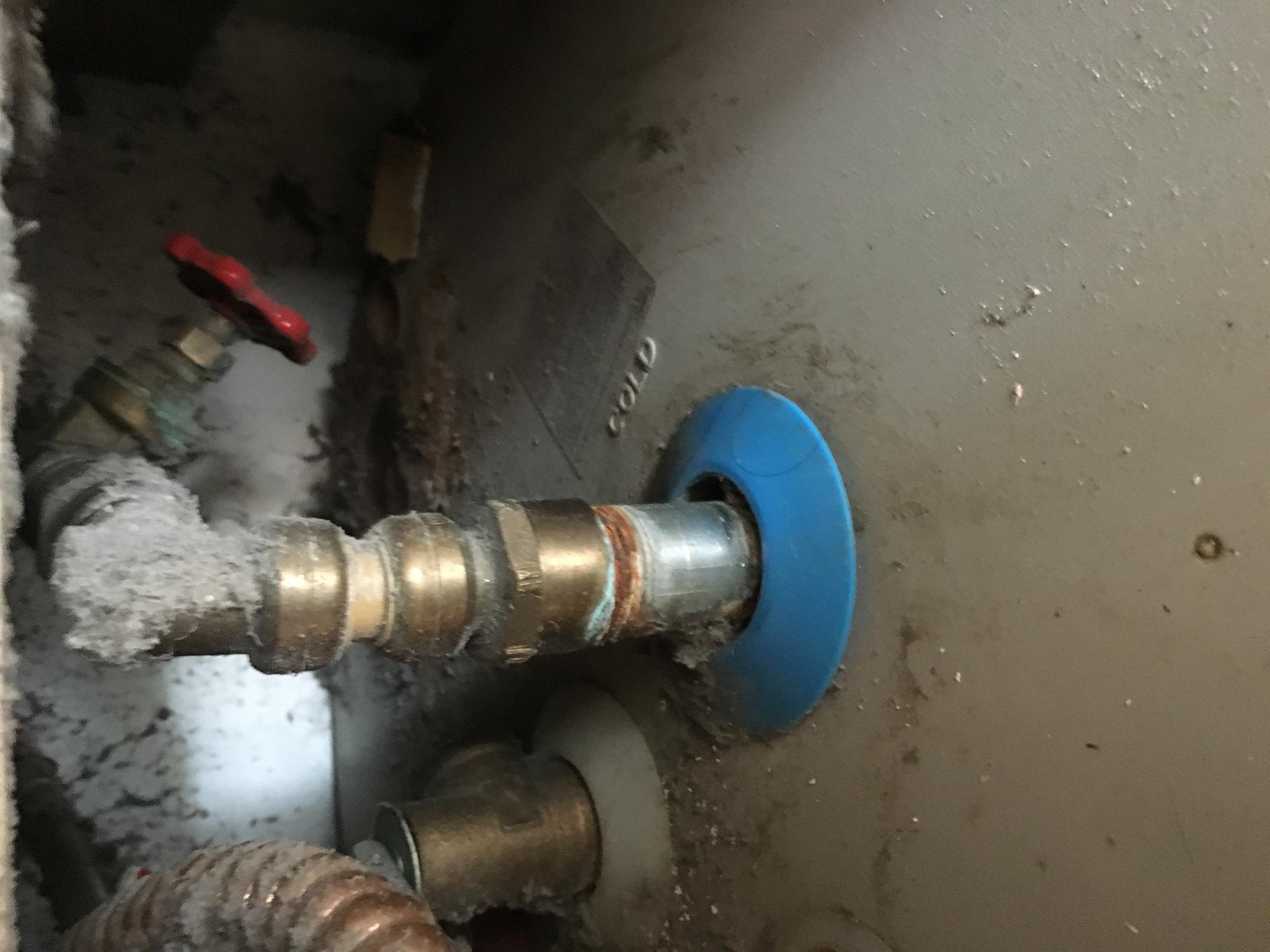

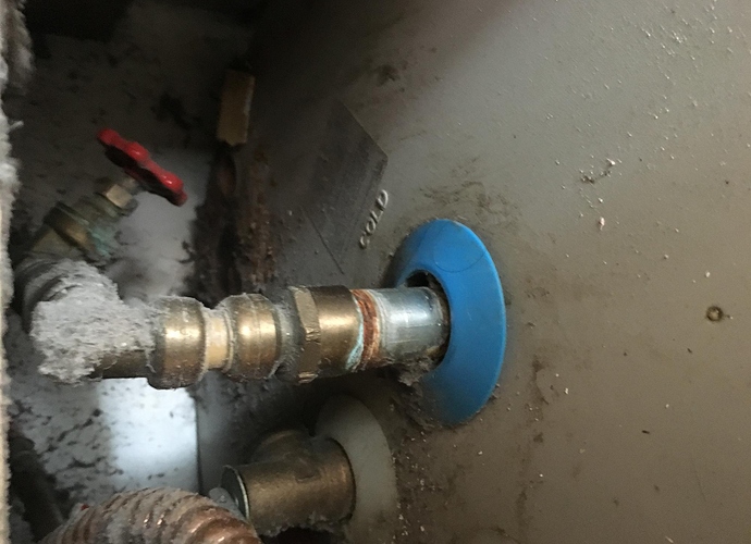

I inspected the water heater at my own home as you can see from the pictures below there are all the manufacture stickers with warning and requirements and it has enough room for maintenance also the TPR valve is in the top 6 inches of the tank and there is a brass drain at the bottom of the tank the only thing I noticed about this that isn’t a defect but something worth mentioning is water inlet and outlet on top of the tank connect to the water line with compression fitting’s which are known to leak it was probably done this way though due to the plumbing pipes being cpvc instead of copper I would note this but not list it as a defect.

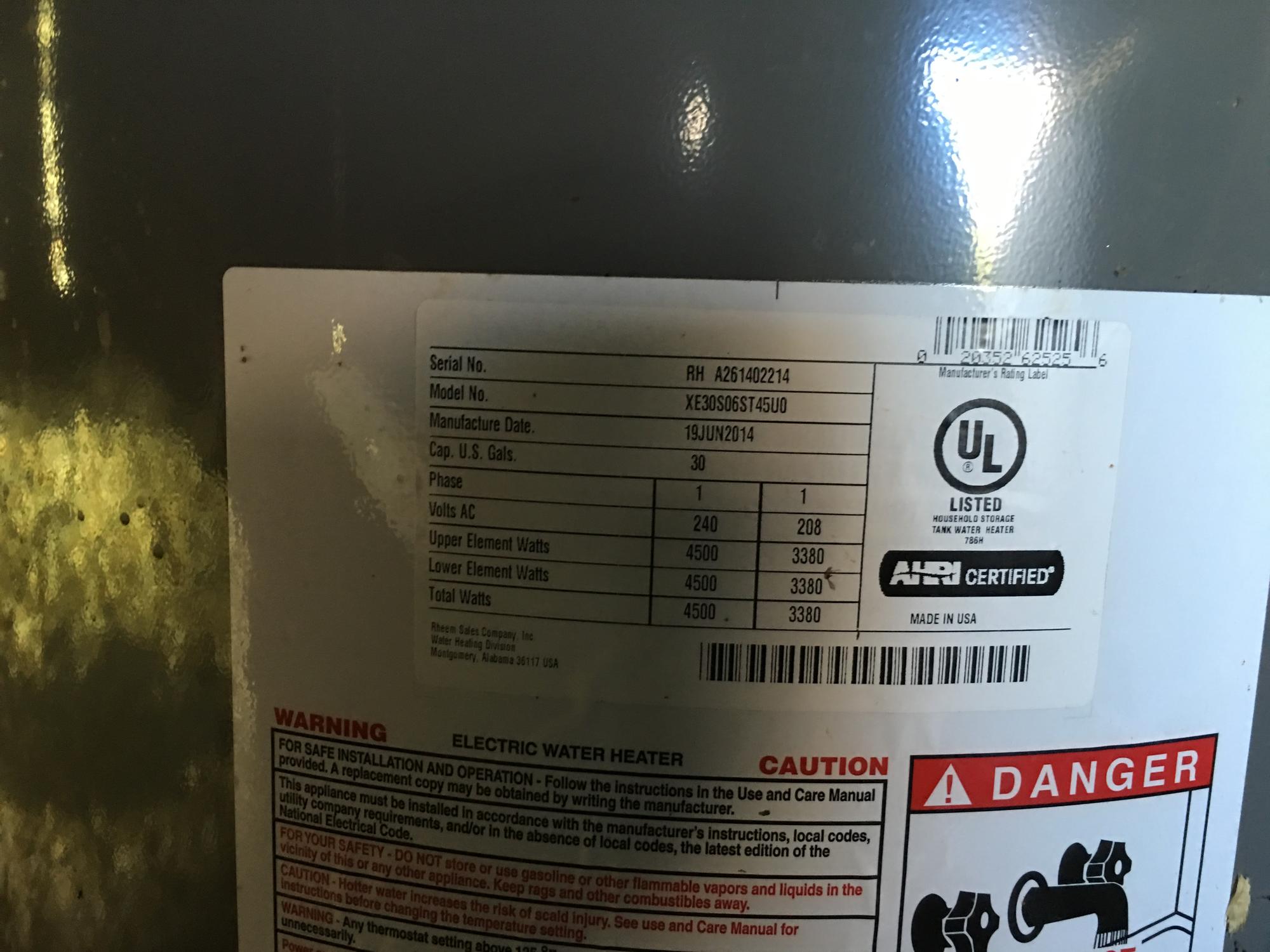

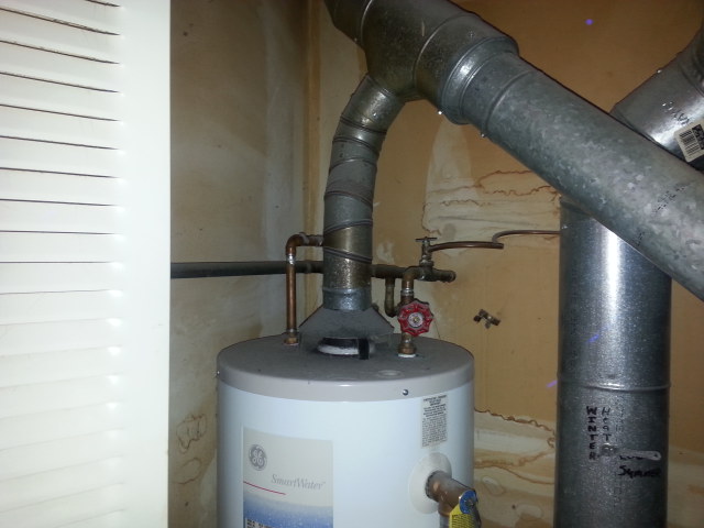

Here we have a water heater of an apartment and it’s located in a closet at the end of the hallway. Right away you can see there are a few challenges with this water heater. On the side there is a date which indicates it’s installation and by that date being 2014 one would expect to see the presence of an expansion tank. Also pictured here is the water heater is in a pan which is good however, the pan is not plumbed to drain away any water in case of a leak.

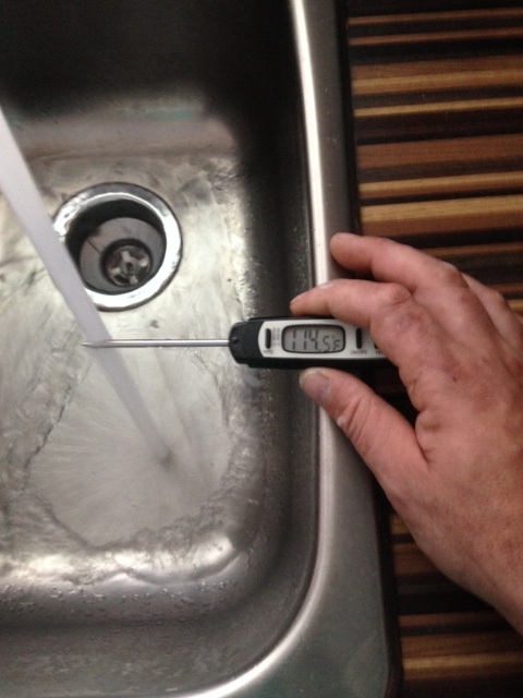

Hot waster is defined as water above 110 degrees F. The water in my house is set to 115 Degrees F to prevent scalding and conserve a bit of energy.
We do not notice a difference in water temperature in our day to day lives, and take comfort in the fact that we will not be burned by our hot water.

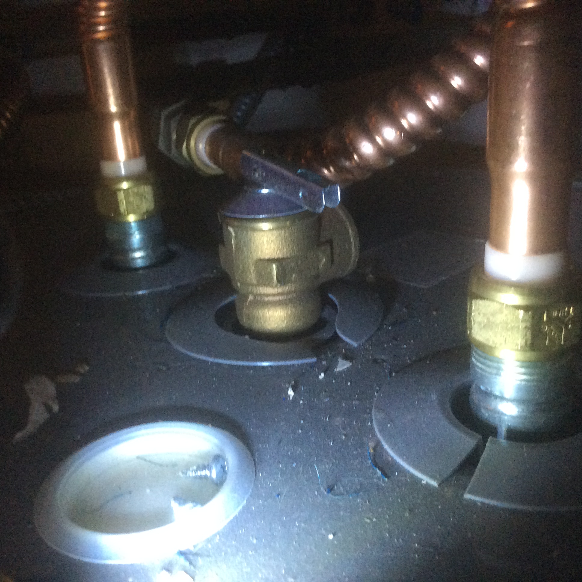

I wanted to do a follow-up to my previous post on water heaters. I wanted to point out another challenge the heater had. If you take a close look you can see that there is no discharge pipe on the TPR valve. There are 13 requirements pointed out in our study material.
  1. It is incorrect for the pipe to directly connect to the drainage system.
  2. The pipe should consist of materials that are tested and rated for the approval of such use.
  3. Termination of the pipe should not be more than 6 inches above the floor. For the complete list of all 13 requirements you can refer to Residential Plumbing Overview section 5.16.

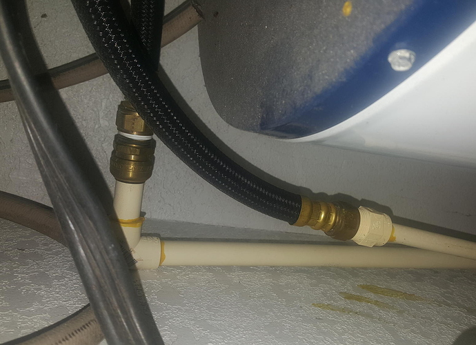

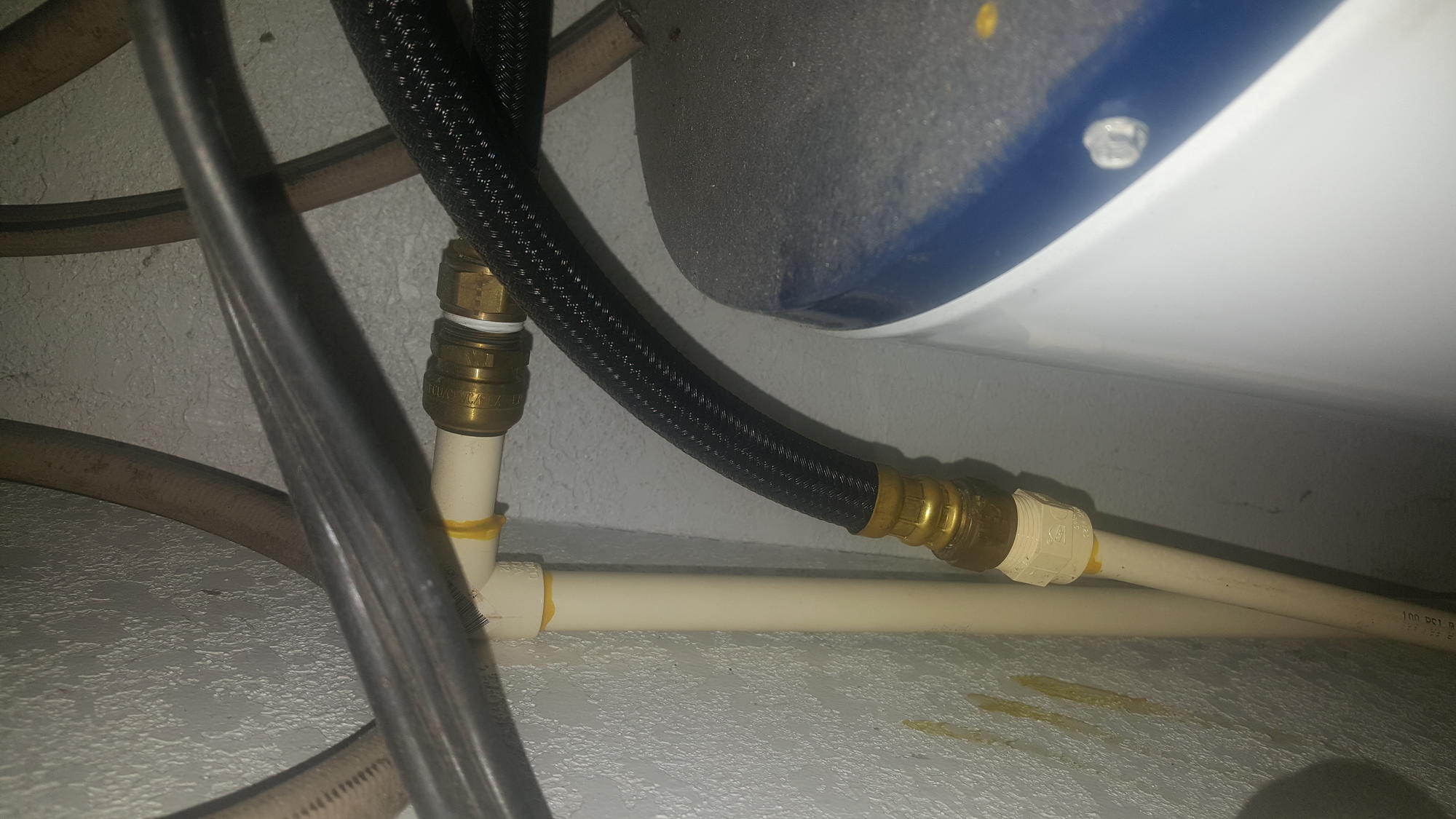

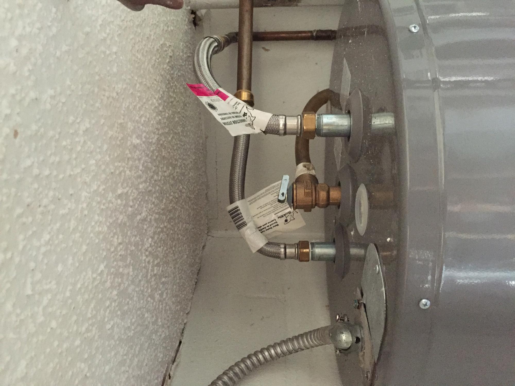

In this picture you can see a fairly new electric water heater installed. I am not a big fan of shark bite type connectors but they are allowed in the local building code as long as they are accessible and not covered up. I have never actually witnessed a leak using them but I have heard that if not properly installed the possibility exists.
Water heater expansion tanks.
It is my understanding that even though a expansion tank is not present its not a defect, however, an inspector must note it in his/her report.

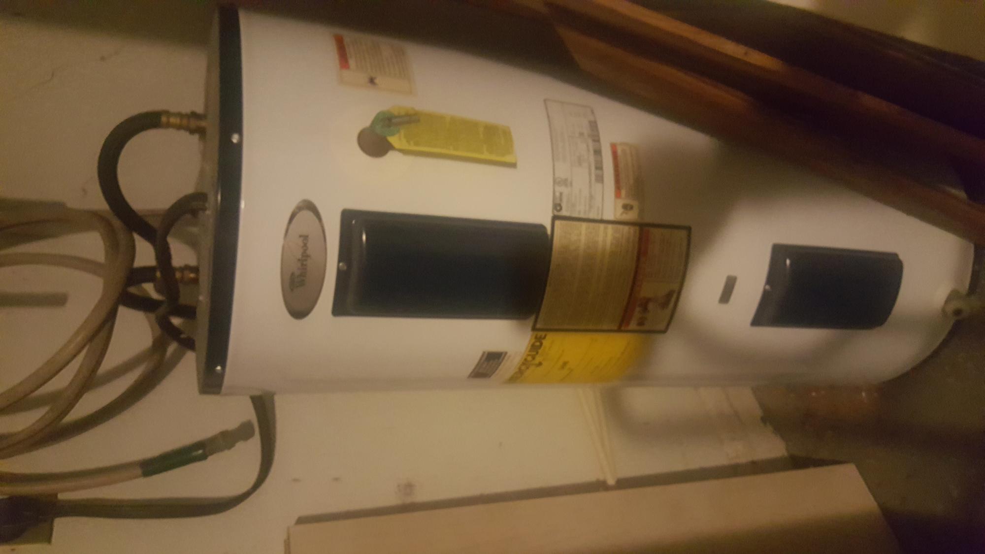

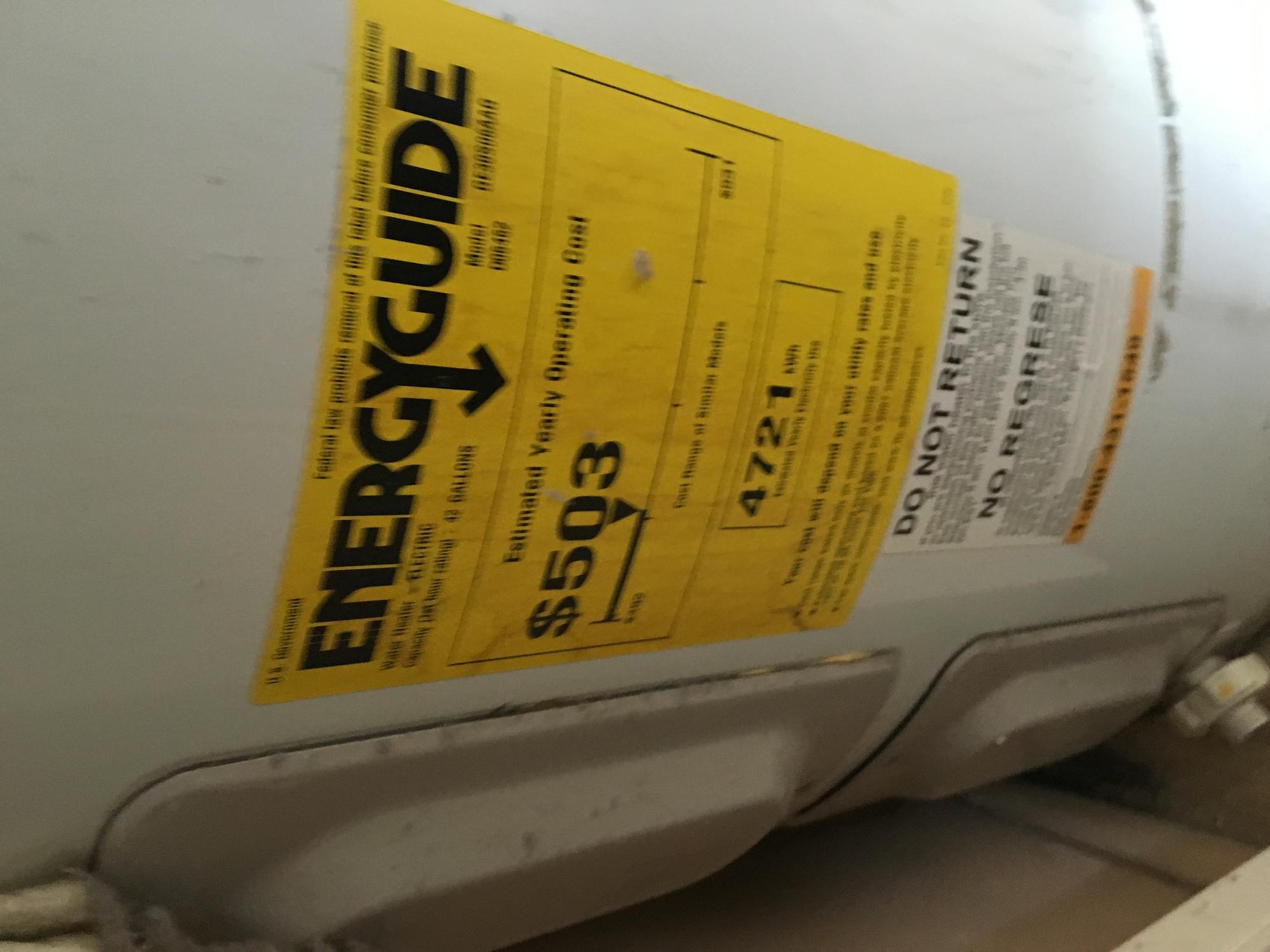

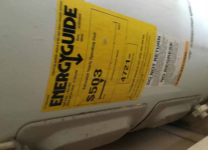

I have attached a picture of my water heater; I’ve used this for electrical, as well. The label shows the water heater was made in 1994. The inspection shows no issues with rust and no signs of water leaking anywhere. The pan is broken and the TPR runs outside. The shut off valve is non functional and the electrical is unsafe.
I read “InterNACHI Water Heater Dating Chart” and “Water Heater Expansion Tanks” from the library. The dating chart is helpful if you can’t find an “Energy Guide” label which will show the year so you have an idea of about how old the water heater is. It’s helpful understanding how the expansion tank works in conjunction with the rest of the plumbing system. The expansion tank information has been covered in other sections but you can never know too much.

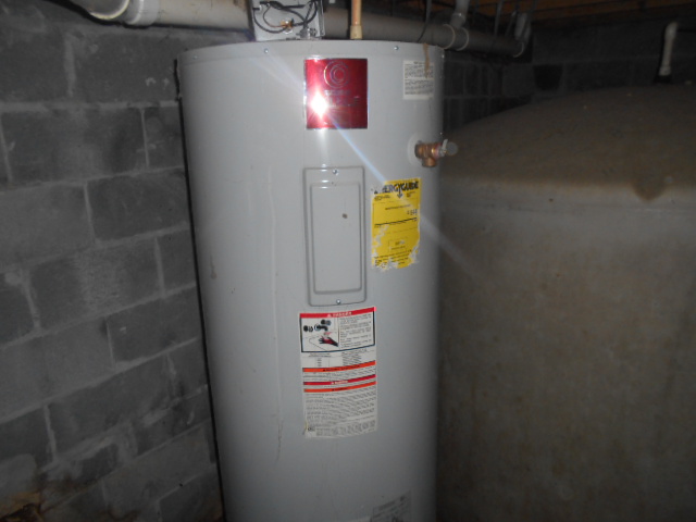

This State Select water heater was located in a crawlspace. IT was an 80 gal electric. The disconnect above the water heater was loose and double tapped. The TPR safety piping was also missing.

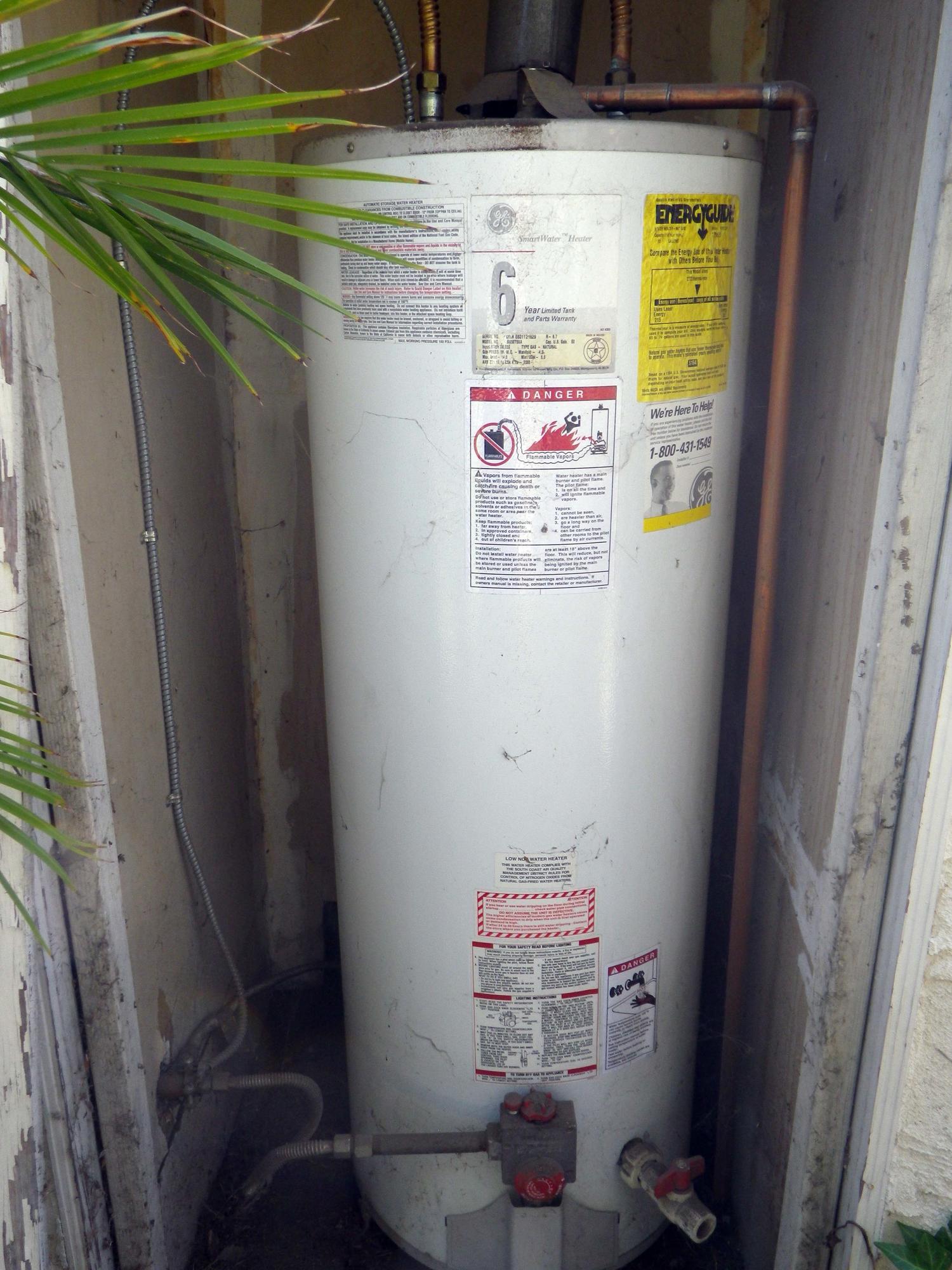

Here is a water heater for use by a guest house which is part of the main dwelling. There are two water heaters to this home, The main water heater is fairly new and to code, this water heater still works however its been in service for approx 15 years. Seismic retaining straps are not installed and should be located one at upper third and one at lower third.

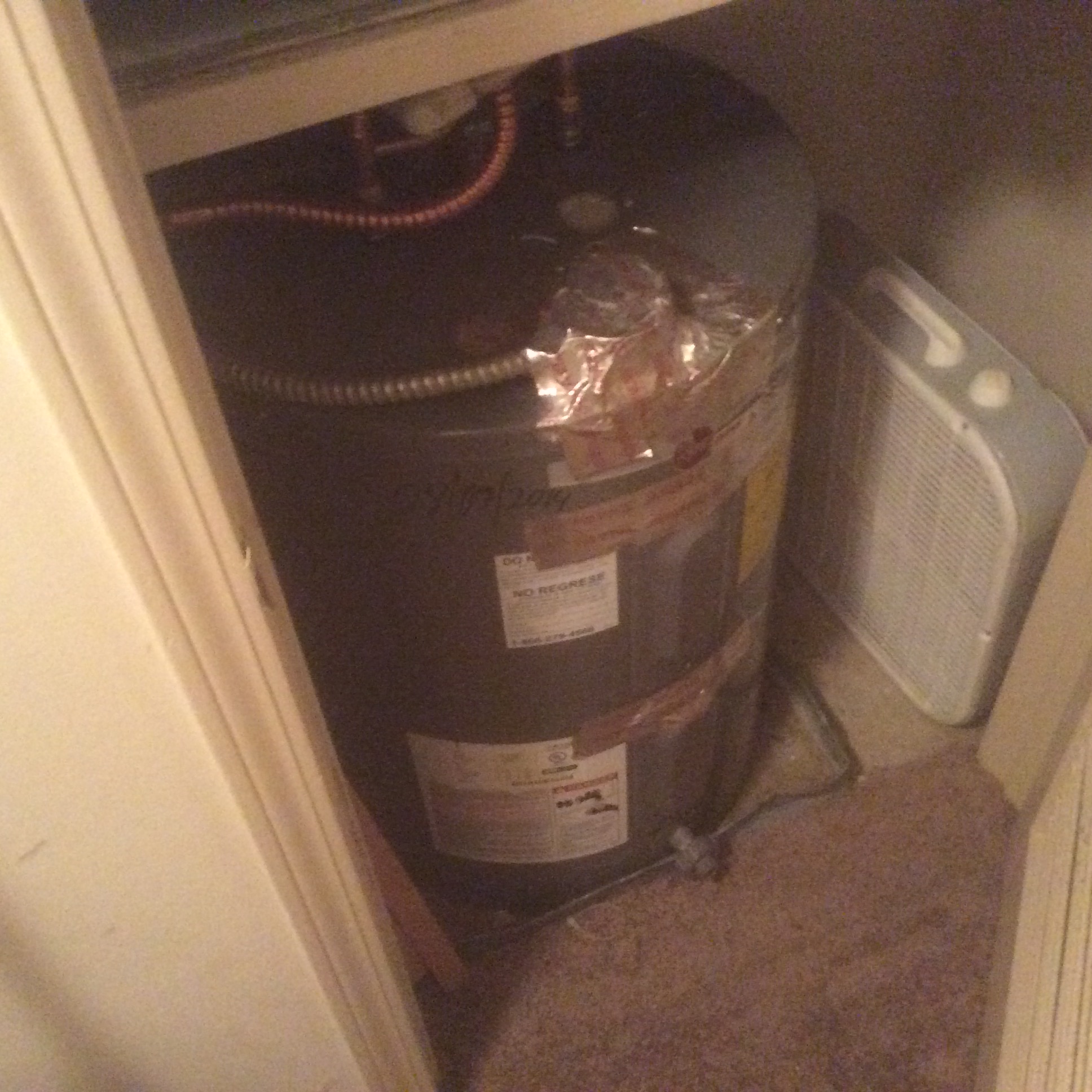

Residential water heater of a town-home was located on the hallway in the kitchen area. It was an electric water heater with a 42 gallon capacity.
Unit located inside a closet with louvered doors provided room temperature with ventilation. Unit had 40 inches inches of frontal room area. In order to inspect the remaining 60% of the unit, the water heater would had to be removed. The obstruction was noted.
With limited visibility I was able to determine that the water heater did had a TPR Valve but no visible discharge pipe. TPR valve was located at the top of the unit and in case of discharge, depending on pressure it may scald or injury any person in the area. This is a safety hazard. Additionally, the lack of TPR discharge pipe, any discharge will leak onto the unit and cause further damages to it and surrounding materials.

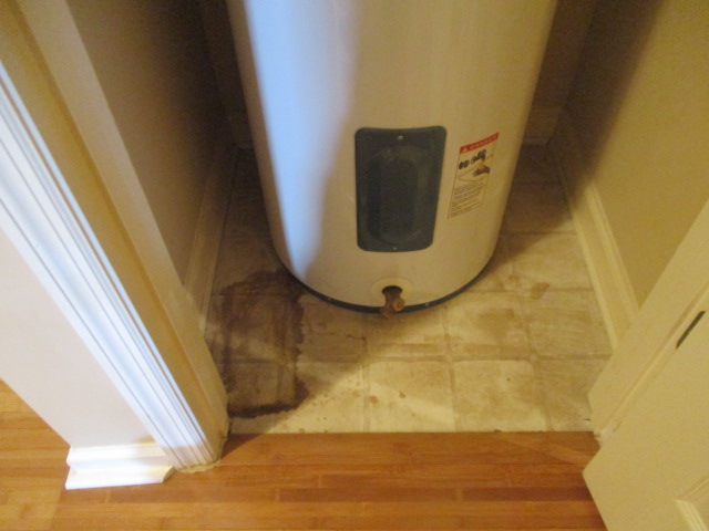

The attached photo shows an electric water heater inside a residential home.
The water heater had no apparent signs of leaks, the electrical connection was properly secured with a strain clamp and the TPR discharge pipe extended to within six inches (6") of the floor.
The only notable problem was that the water heater was installed inside the interior of the home without a water leak catch pan. At this residence, hardwood flooring made up fifty percent (50%) of the interior flooring.

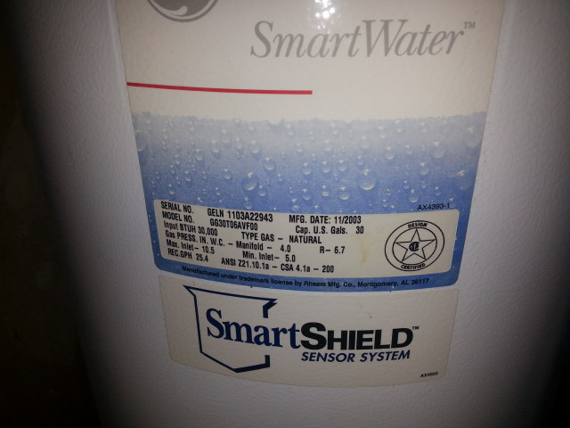

i read the article on deciphering serial#, model #'s on a water heater. It is incredibly helpful to know the year of manufacture and install.

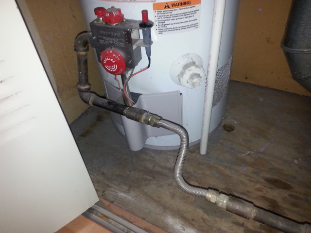

I just looked and inspected my water heater. We had it installed about 12 years ago. My close friend, who is a pipefitter took care of the installation, he purchased and installed the tank. I guess I should talk to him about the lack of a drip tube for the gas line. Oh well, you get what you pay for. :slight_smile:
Everything else appears to be ok and functional.
Drip leg.
Seeing that my own water heater does not have a drip leg on the gas supply line, I researched the problem.
I have decided that I will need to install a drip leg on the gas supply system to the water tank.
