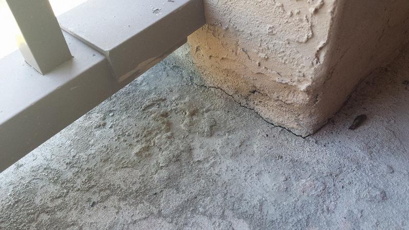

Hello everyone,
I tool 3 photos of my rented home’s balcony.
There seem to be some str.uctural flaws holding the railing up, including cracks in the foundation, bolts that don’t appear to be attached completely flush, and the area where the concrete and soil appear to need to be more filled up and pressurized
