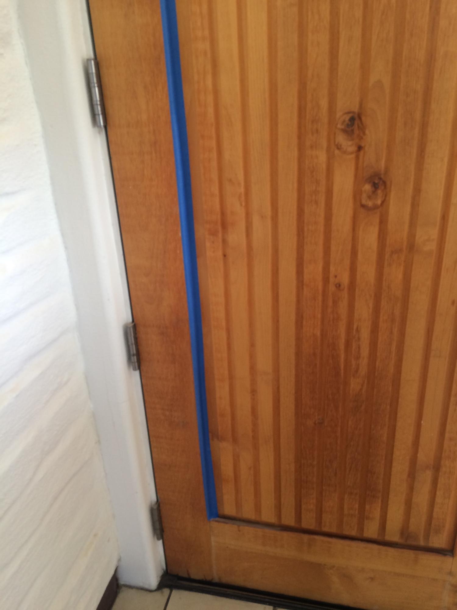

(Robert P. Stanley) #29
Performed Energy Audit for home in Placitas, NM. Inspection revealed multiple areas of energy loss.
  1. Front Door of residence shows evidence of air leakage that has been taped to prevent air penetration and whistling.
  2. Thermal Pane Door shows loss of seal between panes. Similar evidence of seal damage seen in several windows.
