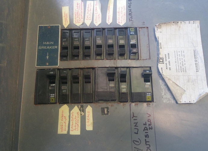

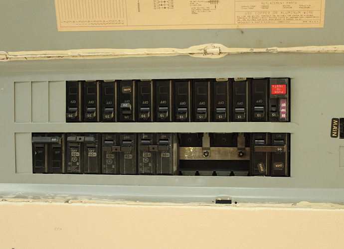

This picture of a residential sub panel shows several problems. First it appears to have previously been located in a garage that has been converted and now covered with a modified cabinet panel.
There are several missing attachment screws, there is no legend of the circuits, the original one is completely inaccurate and faded. There is a modified protection of a breaker that the installer appears to not want turned on. It also appears to have breakers from multiple manufacturers.

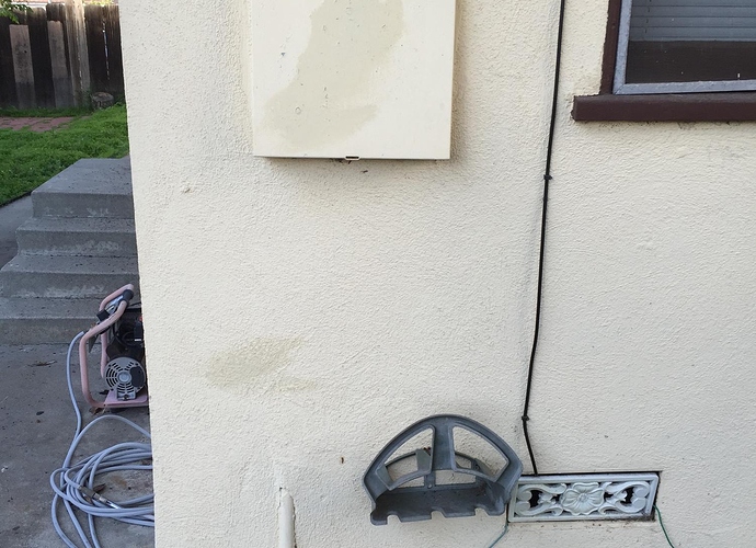

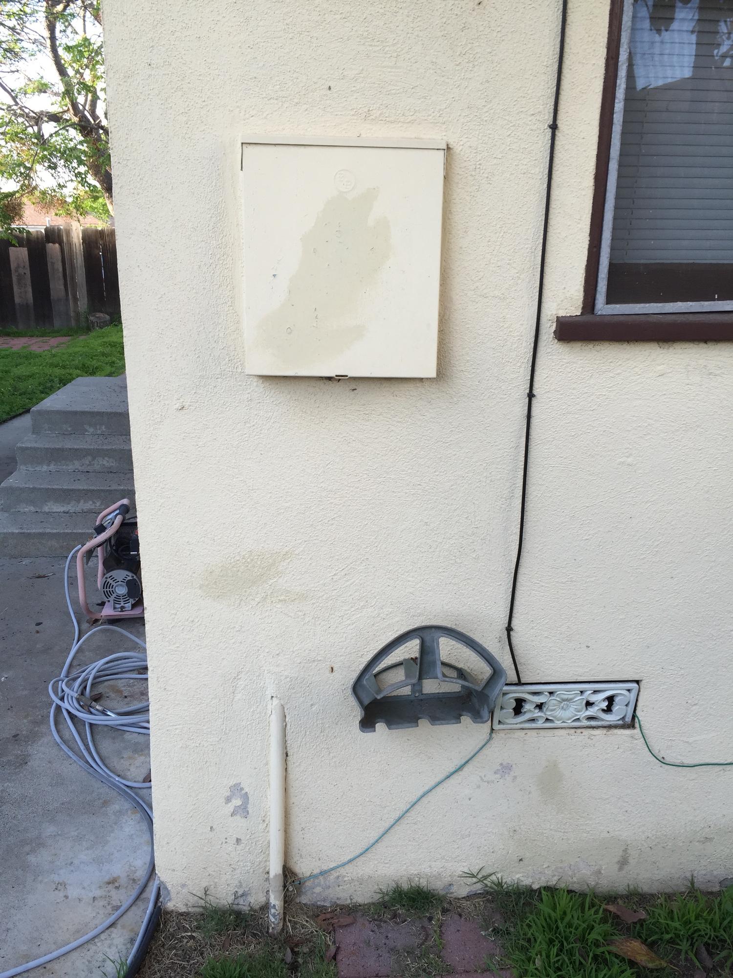

This image is of a 100 amp service panel installed on an older single family residence. The panel was manufactured by Square D and has all Square D circuit breakers installed. There are a four issues that are problematic for this unit:
  1. There is a unlabeled circuit breaker.
  2. There is a missing screw that is supposed to secure the dead front to the panel enclosure.
  3. The overhead mast attached to the panel with the supply conductors from the local utility provider is located underneath the roof eve and not mounted to the roof top.
  4. The service drop conductors are within three feet of an operable window.

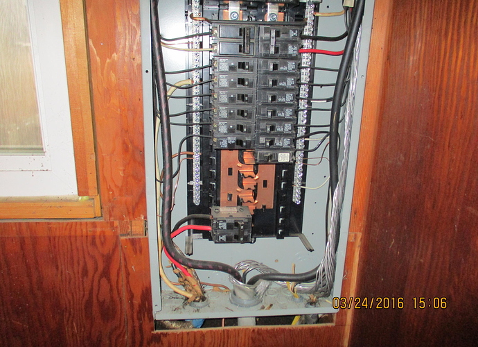

The above image is from a recent inspection. The panel is missing multiple knockouts without without filler plates installed. The dead front does not sit flush and causes a gap around the lower right breaker. The 60 amp breaker on the lower right corner feeds a sub panel in the garage with a 8 awg (copper). The sub panel in the garage is also wired for a generator with a 50 amp breaker and wired with 10 awg (copper)

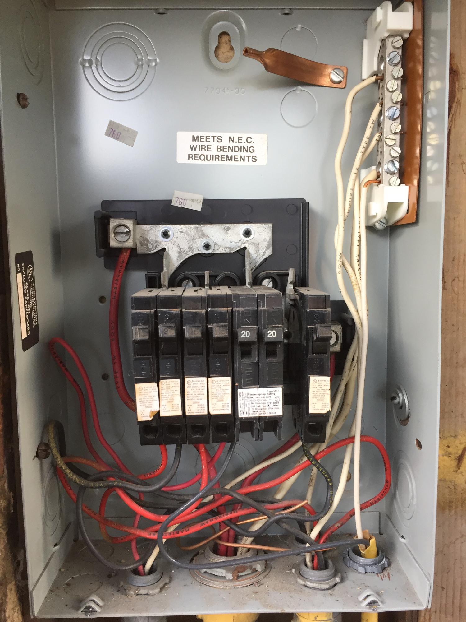

100A Remote Distribution Panel used as the main service for a rear duplex unit. Main feeder breaker located at the front unit. 8-position panel with no main shut-off. Missing twist-out. Two 20A breakers are unlisted replacements—missing twist-out to accommodate the extra breaker width. Panel not bonded to ground. No ground buss. No indication of earth or supplementary grounding. Neutral wires too tight on buss. Excess line-wire length in panel. Unconnected ground wire loose in panel from NM branch. Underground entrance conduit—incorrect building entrance. All Flex-conduit and NM cable entrance at bottom of the panel implies a covered junction box or conduit transition and/or possible wire splice with the underground conduit. Supplementary grounding on service entrance conduit should be moved to cold water entrance. Panel area interior the wall is dry.

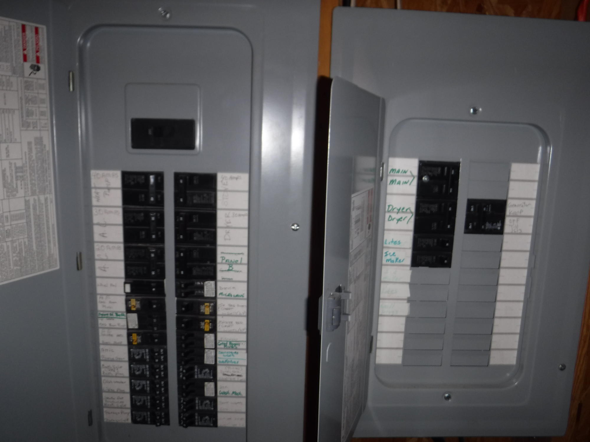

The picture above shows a proper main panel and sub panel in a basement. All breakers/are correctly labeled. There are no unused knockouts. And all of the front panel covers have the correct screws holding them in place. The service has a ground rod connection and is also attached to a water pipe for proper grounding. The electrical inspection would also include both of the front/dead plates for observation of the interior of panels.
