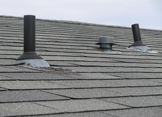

My roof inspections photo shows a plumbing vent pipe and boot flashing. The flashing is tar covered which indicates a problem with the flashing that may be causing leakage. Unfortunately the tar covering is a temporary repair that will need to be done over and over again. Replacing the boot flashing is the best and most permanent repair.
