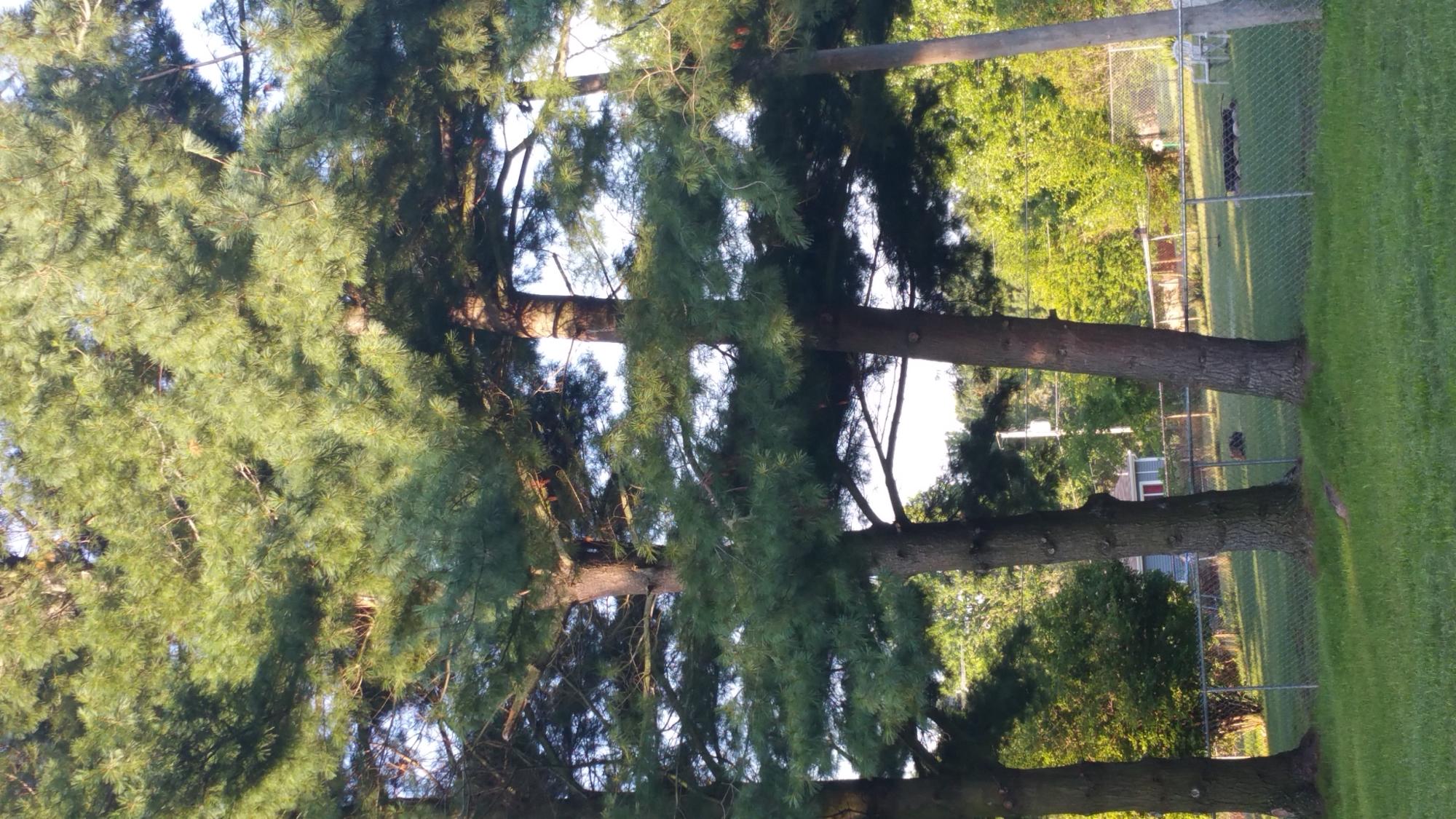

Here is a white pine tree somebody planted to close to the overhead power lines. The soil is very sandy and as you can see the tree is leaning into the electrical service and a few branches are touching. Also the roots are coming up at the bottom left hand side of the trunk. I advise contacting the power company to see if they will remove the tree for free, sometimes they do.

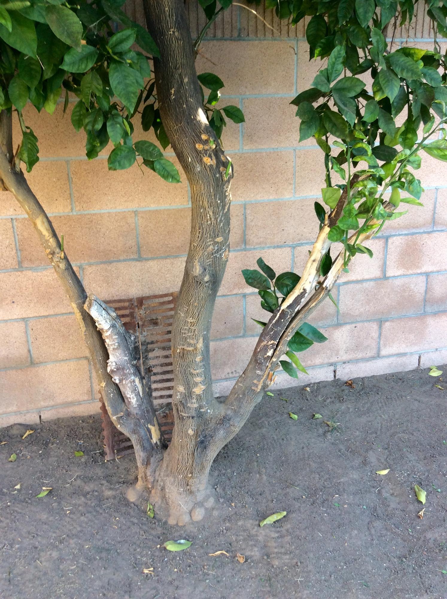

This is a photo of an orange tree in my yard. This is an example of a tree with multiple trunks. The trunk to the right split because it was growing horizontal and became too heavy when oranges grew, so I had to cut it. There are only two trunks that are currently active on this tree. What I found interesting was that I noticed the two parts of the crown that correspond to the two trunks bloom and produce oranges at different times. When oranges are on the tree, they are usually on one half or the other. Most of the damage to the trunk is from my kids playing around the tree.

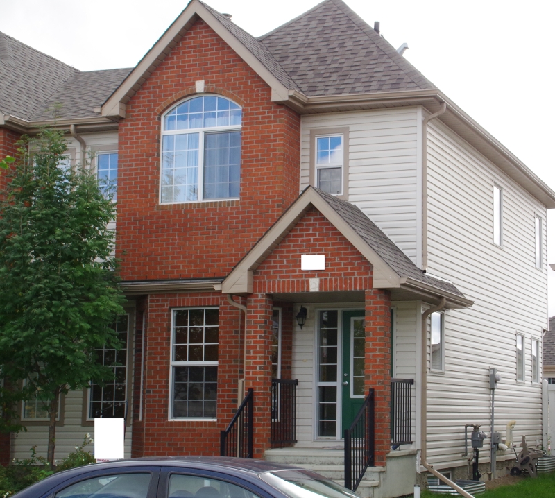

This Mountain Ash (Sorbus aucuparia), a medium size ornamental tree may have been planted too close to the house. The tree has already grown over the gutters of the lower roof, and is close to reaching the upper roof, which is quite high and steep, making gutter inspection and cleaning difficult and potentially dangerous.
Without pruning the Mountain Ash can reach heights of 40 feet or more, with regular pruning the size of this tree can be controlled and held at or below its current size.
