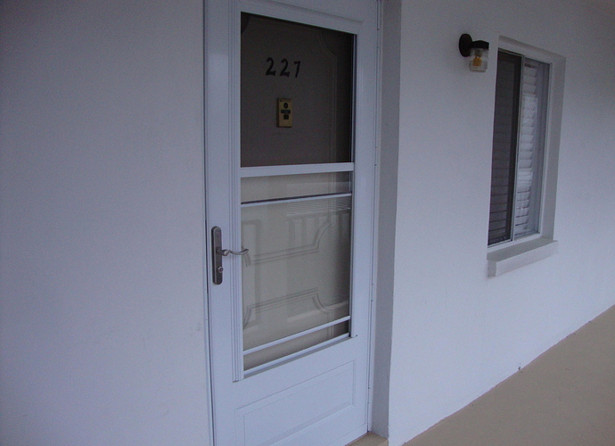

The picture above is the front door and window of a 1997 Clearwater, Florida home. There are no stickers or protective covering present. The window is single pane with no markings and the door that opens in has a screen door with no markings also. No Windborne Debris Protection should be checked on the glazed and non-glazed openings chart on a Wind Mitigation Inspection Report.

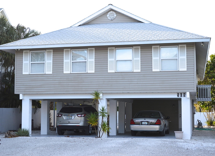

The attached photo is of a two story house located on Anna Maria Island. The roof measures 196 feet around the perimeter and has two gables located at both ends of the house consisting of a total of 24 feet. According to the wind mitigation formula of gable length divided by the total length of the perimeter, this roof does not qualify as a hip roof. The total area of gables in relationship to the perimeter of the roof structure is 12 percent. The total allowable percentage can be no greater than 10 percent of the total perimeter length. Bummer

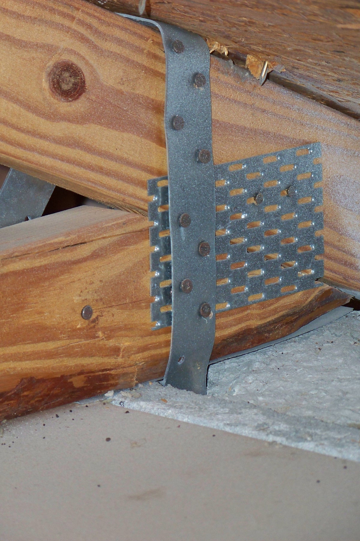

This roof to wall attachment was observed in a single family residential home on a wind mitigation inspection in 2016. The single wrap extends over the truss with the proper nail count on the front and backside (not shown) of the truss. The single wrap was free of rust or damage at time of inspection. The wrap was also the proper distance to the truss, butting directly against it. The structure had single wraps on every truss with the proper nail count and distance in relation to the associated truss. The structure was built in 2006 to the current FBC (Florida Building Code).

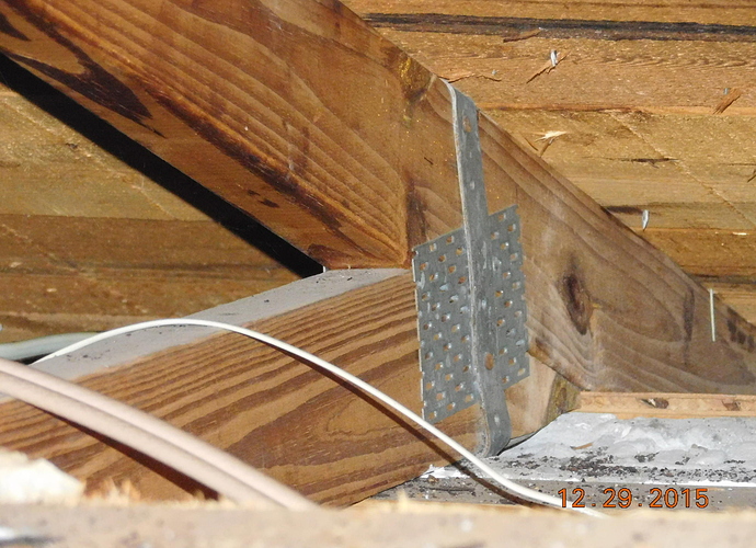

This inspection which was performed in Hudson, Florida back in December of 2015 was the most recent wind mitt inspection to date. Most of the inspections that I do in Florida do not require wind mittigation inspections. Frankly, I have to give discounts to perform them. This single strap is secured properly using 3 nails, 2 on the front and 1 on the back side. The top nail on the front side is too close in my opinion and was noted on my report. I understand that 3 nails are the requirement and it really does not specify where the two nails on the front side should be.
