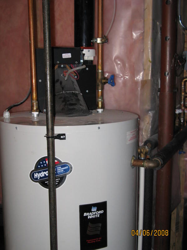

Yes, a specific WH is to be used.

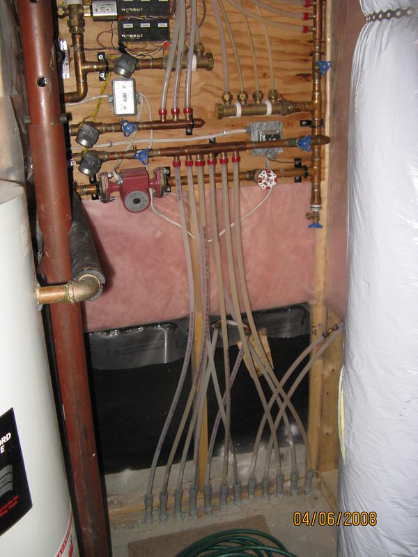

Attached are some pics from a Bradford White WH used for such a system.
There is a heat exchanger inside.
Just like a furnace, but for water instead of air.
