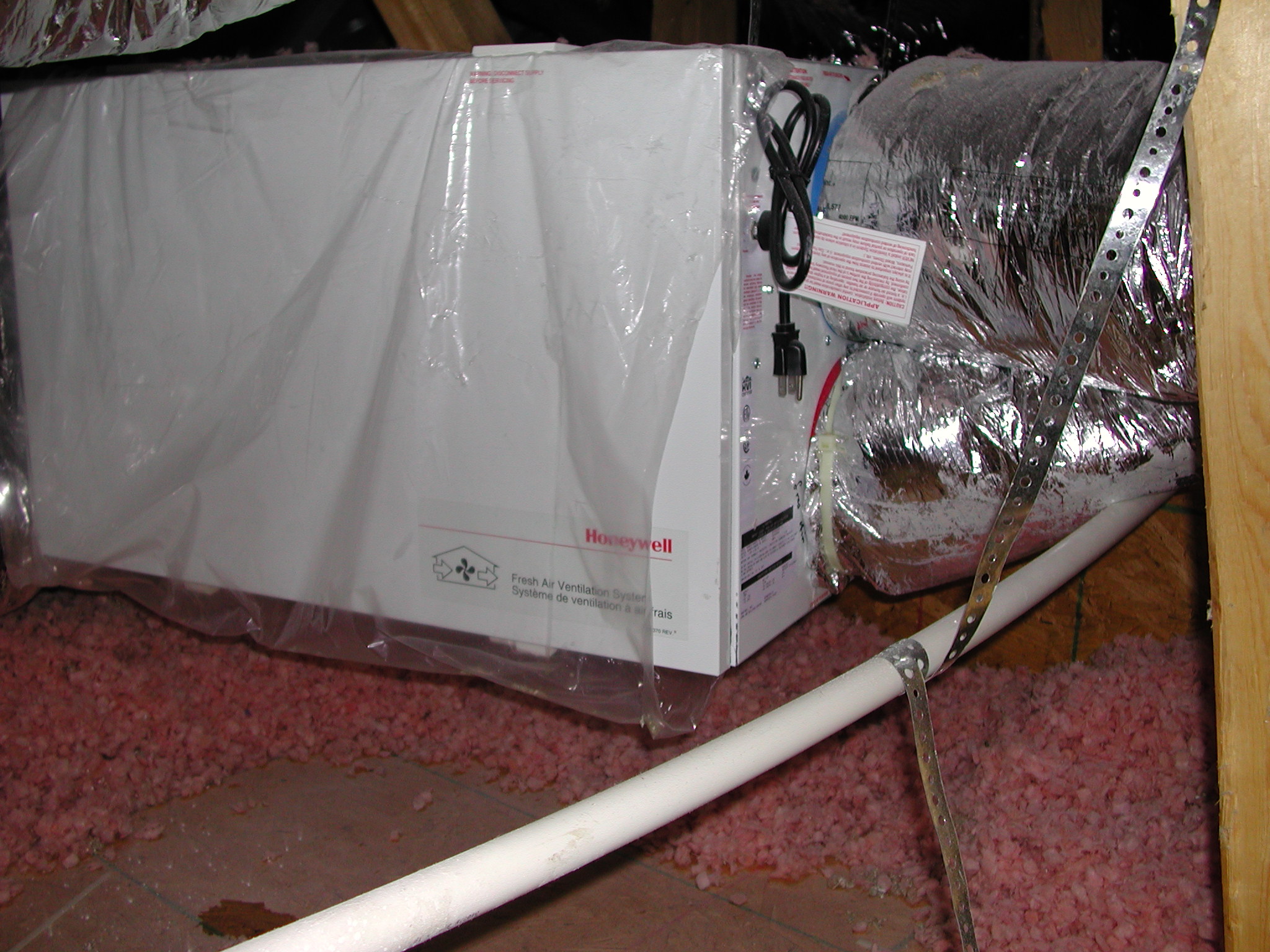

I wonder why this doesn't work....
Originally Posted By: rdawes
http://www.nachi.org/bbsystem/usrimages/D/DSCN1919.JPG ]
Found in a one year warranty inspection.
Originally Posted By: chorne
what is it supported by? and where is the drip pan?
Originally Posted By: Gary Reecher
Yes unit unlpugged. Flex duct crushed and most important installed in the attic where the homeowner will not most likely change the filter. But most important to those that have to service and repair the unit is there access???? ![icon_evil.gif](upload://1gvq2wV2azLs27xp71nuhZOKiSI.gif)
