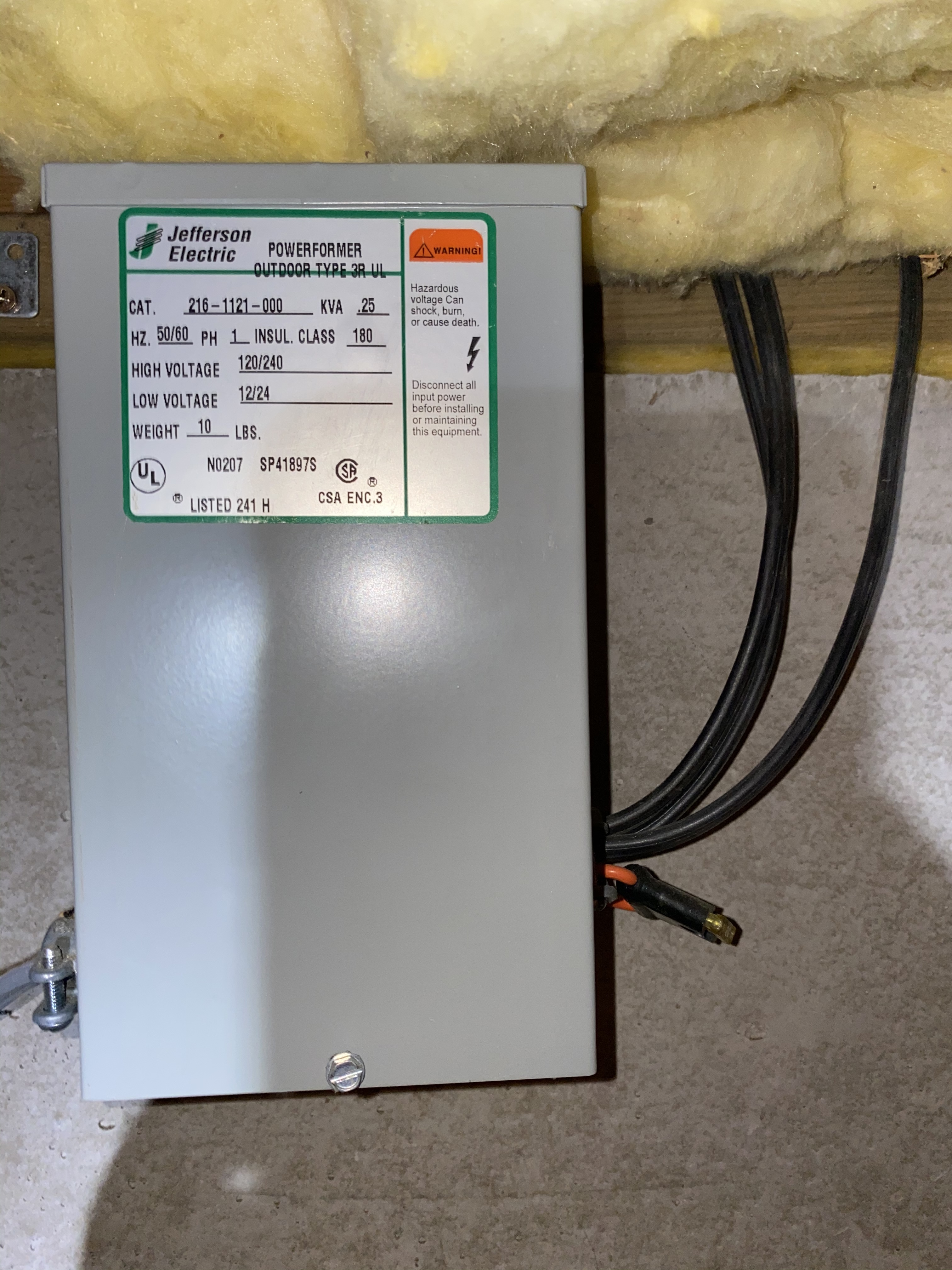

Identifying a powerformer
Any idea what this could be for? It’s near the sprinkler system controls but don’t appear to be connected to that directly.
The 3 cables coming out are marked kichler lighting 12 awg underground low energy circuit cable sunlight resistant. My non contact voltage tester isn’t showing a voltage at either end and the receptacle it s plugged into is also dead.
High voltage transformer perhaps for outdoor lighting
https://www.galco.com/buy/Jefferson-Electric/416-1121-000
Almost certainly low voltage landscape lighting.
