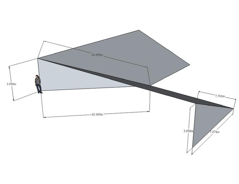

I found the common rafter would be 23.33 degrees.
I made a drawing on Sketchup (free edition and see attachment).
I used the metric system.
Made the base line at 10m, then in order to get the 17 degrees angle, I calculated that the opposite side of the roof pitch needed to be Tan 17x10= 3.05m
Now, I have my triangle.
From there, I did a simple squared roof on each side of the valley, then measured all sides of the new triangle in order to calculate the common rafter pitch by doing:
Tan-1 (3.05/7.071)= 23.33 degrees.
Unfortunately, the free edition won’t give me the angle, so I calculated it with the dimensions on the drawing (anybody else can proof this)

The angle of the common rafter = Tan-1(Tan 17°/Cos 45°) = 23.38°
That translates to a 5.19:12 pitch.
And that’s the faster way of doing things :smiley:
