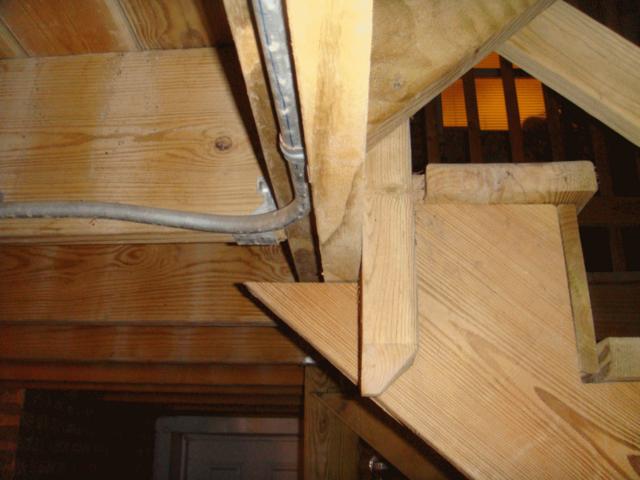

Just curious, If this was your Inspection ,what would you say,and what would you report?
Back up your opinion if you can,rather than hearsay.

I am sure things are different up in the windy city. We get to use romex here.
Pic 1 I would need more clarity on the requirements there, but washers would be nice. Here it would be nails.
Pic 2 Thats obvious. Just exactly how are the steps secured, by toe nailing?
Pic 3 You lost me there
Pic 4 The steps look to be undersized and there is too much space inbetween the rail and the steps

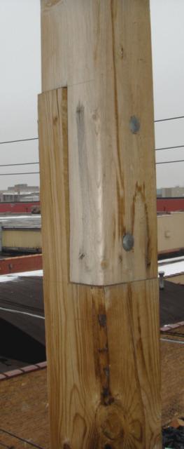

If it helps this is a 3 story porch.
The stamp is the only stamp on the wood.
Will explain later if no one figures it out.
This is not a good structure, so I will wait a bit and maybe add a few more issues.
These issues are very easy to miss , which is why they are important.

Column splices could have been avoided by using an engineered parallam in full length.
This bearing post splice may not have taken into account the axial loading and may give way in the future to lateral forces cause by it.
Recommend a designer to evaluate and corrected based on the loading requirements.
The header framing for the stair stingers is inadequate to meet todays standard application for this installation.
The header should have been increased in depth to accept the plumb cut of the stair stringer and allow for proper Simpson anchor attachment.
Needs to be repaired by a qualified Building Contractor.
The general view of the stairs, appears that the tread width and riser proportions were not taken into consideration for safety when originally built.
The slope of the stairs should not exceed 38 degrees to provide safe access during use.

First is the stringer sitting directly on concrete, which is not much better than earth to wood as it wicks up the water.
Since we are on stringers here is a issue from the first group to look for.

Wrong illustration for stringer contact above and can’t delete.sorry.
The first picture shows a column not spliced properly as 2 bolts is proven to not be enough to support the splice.
5 is the amount required now.
The one below shows how the column should attach to the footing and pedestal.
