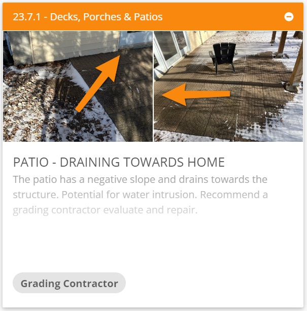

  1. I have an overhang / cantilevered kitchen and dining area with a large deck attached.
  2. Sliding door (not the one pictured below) that opens to the deck was not able to open 100% and bound up when opening
  3. Basement bathroom fan is venting into garage
  4. Some doors (which were entered through by the inspector) did not latch correctly
The deck on the overhang, I’m now finding out, is a no-no unless it was engineered to handle it. I would have thought this would have been something to note, as it appears to be a safety issue and this video outlines why (an InterNACHI educational video) .
Come to find out, the reason for my sliding door sticking (not the one in this picture below) is because the floor was pulled down and causing the bind as a result of the floor joists being off, as described in the above video. After digging more into it, there is a dip in the joists as shown in these pictures
You can slightly see the curvature on the basement ceiling where the deck is attached
When I do the marble test in the kitchen / dining area, it moves fast towards the belly of the floor. We planned on replacing flooring here but will need to fix the issue caused by the deck first.
On the report, there is no mention of the issue with the deck, only a sloping issue.

Decks should not be attached to any cantilevered portion of the house. The deck should be fully self-supporting and in the picture it looks like that is not the case. IMO, that is hard not to miss, especially with a visible sag in the floor. In your case, it is probably going to take adding supports (beam(s) and posts) and, hopefully, that will alleviate the related issues.
The sliding door would be easy to miss if the door opened normally for the most part.
The bathroom fan venting into the garage sounds like a possible firewall breach. There can be no vents, holes (passageways for air) in the wall between the house and attached garage. Since it is his picture, he should have noticed and reported that. The vent needs to discharge to the exterior of the house.
If the doors that did not latch properly were interior doors, then that is only a minor maintenance item and it is perfectly acceptable for a home inspector to deem that as non-relevant (not worthy of reporting), along the same line as scratches, dents, nail holes, and so forth.
