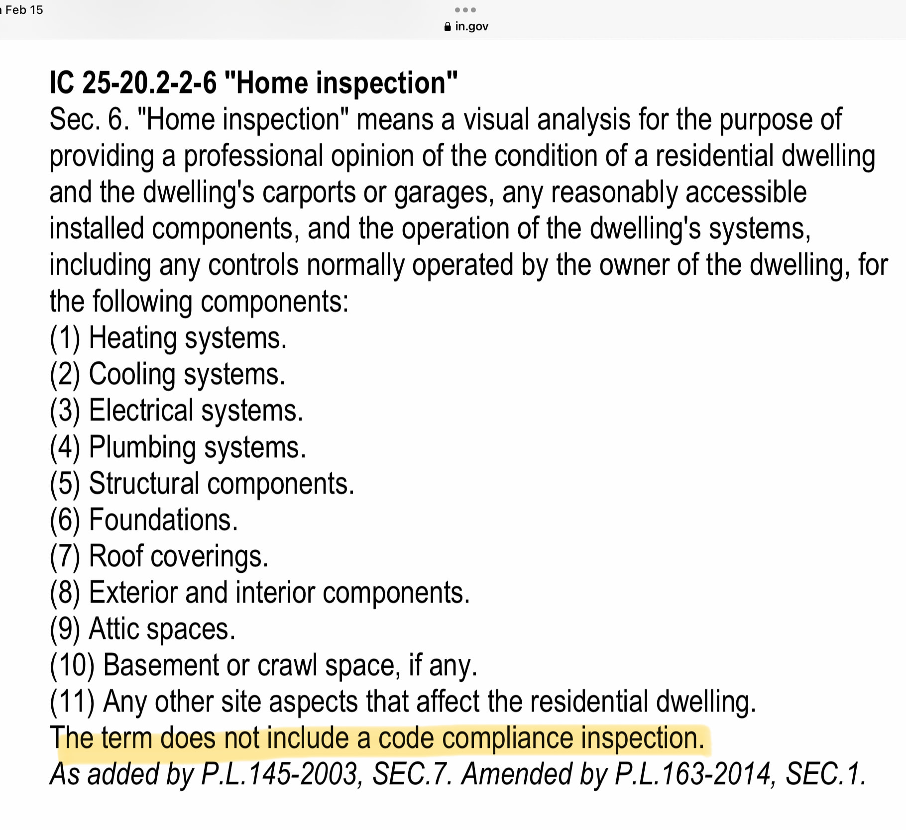

Just finishing up my mock inspections for certification. Learning a lot along the way. Is there anyone on this site from Indiana that can chime in? I’m trying to differentiate “code requirements” in Indiana, specific to electric, from what I learned in my coursework. Regarding AFCI, not required in any part of the home, so not a defect if a home does not have any AFCI protection, correct? According to this: Learn where the NEC is enforced. | NFPA Indiana follow the 2006 NEC. Nothing like being 20 years behind…

Your question tells me that you are already heading down the wrong path. You are not a code compliance inspector and it would be impossible for almost anyone to know all the applicable codes spanning more than a hundred years.
Inspection schools, including InterNACHI, talk about building codes because they are pandering to their audience. They are doing a disservice to inspectors. You should focus on your SOP, not building codes.
The attached image is a screenshot from the SOP on the official Indiana website. It is the official Indiana definition of a home inspection.
The short answer to your question is “No”. The absence of AFCI is not a defect.

Mikah, I agree with George, a home inspection is not a code compliance inspection. What that means is that we do not have the authority to compel someone to comply with code. We are informer’s, not enforcers.
But this doesn’t prohibit you from having code knowledge. It dispels myths and helps you unlearn some of the fallacies that InterNACHI teaches.
For instance, look at the definition of “unsafe”, as defined by Indiana SOP. It may include “a change in accepted residential construction standards”. That may include making a recommendation to upgrade to AFCI’s regardless of when the home was built. Personally, I do not.
