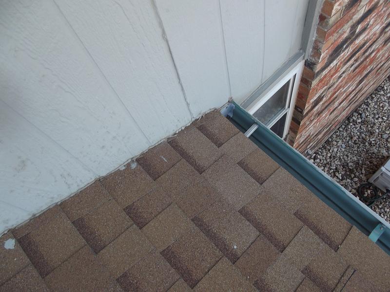

Has any Inspectors seen this?
yep and the dryflekt diverters are a darn good product to recommend when absence is observed regardless of the wall cladding type

It sure would help if the ROOFERS would understand it is the first piece of step flashing THEY need to install.
Hi Bob
We never see kick out here.I call them up every time and get flack for it constantly from the roofers about it.
When they quit saying it is a cladding problem and place the blame on the (roofers) maybe they will open their eyes a little.

What do the roofers say?
I haven’t seen one in this area yet.
One of the last jobs I was on, I actually made one to show them, and they looked at me kind of funny. :mrgreen::wink:

It is not required and if it’s not required they are not going to do it.
A 10 dollar fix for millions of dollars in damage.

ignorance or blatant disregard of interpretation by builders, subcontractors, building code officials and inspectors does not excuse or negate the underlying moisture intrusion damage found when kickout diverters are absent
NOPE! at least not the ones i’ve inspected ;~))
ignorance or blatant disregard by builders, subcontractors, building code officials and inspectors does not excuse or negate the underlying moisture intrusion damage found when kickout diverters are absent

when inspectors become aware of a product that can prevent these damages what’s the harm in recommending their installation?
I know when one trys to tell the (cough cough) officials and builders and other trades things are wrong they do not take it very well.
