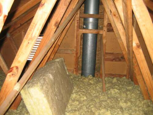

This photo is in the course titled “How to Inspect Fireplaces, Stoves, and Chimneys Course” and I Am just curious if I am correct. This would be considered a defect right? there is insulation against the flue and the wood is not protected at all/ too close?
What type of vent system/chimney is it?
Are you sure there is no dam holding the insulation away at the appropriate distance for the vent/chimney type?
How close is the wood to the metal?

First off, that is a chimney chase and flue. You can not determine if the flue has an inner stove or appliance combustion fresh air intake flue. Double walled flue.
So as being considered a defect, Limitations not visible.
To me it appears to be a double wall flue.

Hi Robert - where are you getting 6 and 8 inch clearances? I’ve always read 1 inch clearance for double wall b vents.
Hi, Katherine. Hope to find you well..
You are correct. I will amend the post. Thank you. I will amend my notes as well. Again. Thank you.

A single-wall metal pipe used as a vent connector passing through a wall, ceiling or floor must be guarded by a ventilated, non-combustible metal thimble, and must maintain a minimum clearance of 6 inches between the thimble and any combustibles.
A non-combustible thimble must be used where a single-wall metal pipe passes through a roof constructed of combustible material. It would be uncommon to find a single-wall metal pipe passing through a ceiling, wall, floor, or roof. For unlisted single-wall chimneys and vent connectors, a single-wall metal pipe used as a vent connector must maintain a minimum clearance of 18 inches between the metal pipe and any combustibles.
House framing components should be at least 2 inches away from the chimney wall. Open spaces between the chimney wall and the combustible building materials should be sealed and insulated with non-combustible material.
Type B vents must be equipped with their own special chimney caps. If the cap is damaged or lost, it should not be substituted with something not recommended by the manufacturer. The clearance required from combustible materials is printed on the flue’s exterior metal surface, and is generally 1 or 2 inches.
OP’s picture represents one of the toughest things in our profession….. you really can’t get close enough to determine all the important things without trampling through insulation, risking damage to items under the insulation and stepping through the ceiling. This limitation is certainly listed in your contract and/or SOPs but it leaves the buyers in a tough spot - you can’t/don’t get there to get a good look and then recommend someone else do so? Trust me, in the heat of an inspection period, this is met with some strong annoyance/anger. Buyers hire us to answer questions, not present them.
Racing through my head - clearances may be incorrect/inadequate, but it’s been this way since 1978…. hmm. I can argue both sides all day long. Honestly, I lean towards letting things like this go if I can’t get there to say it’s wrong. The easy answer is to recommend someone figure out what I was afraid to - get a guy to plow through insulation and make a call. Good luck to you guys if agents and buyers ever call you again after passing this buck. Again, one of the tougher scenarios in our biz.
Without a closer look, it’s impossible to determine clearances or any other defects that aren’t visible from a distance.

Also, if it is indeed a wood buring fireplace or stove, I always recommed a Level II inspection.

IMO, what the OP’s picture shows is one of the easiest attics to cross.
The truss webs are within easy reach to have 2-3 points of contact stepping on the top of the bottom truss cord while traversing the distance. I can easily feel where I am stepping as I move along. And I would carry a child’s small wood/plastic leaf rake to smooth out the insulation as I returned.

Walking on angled roof truss webs can twist your ankles and contort your body.
