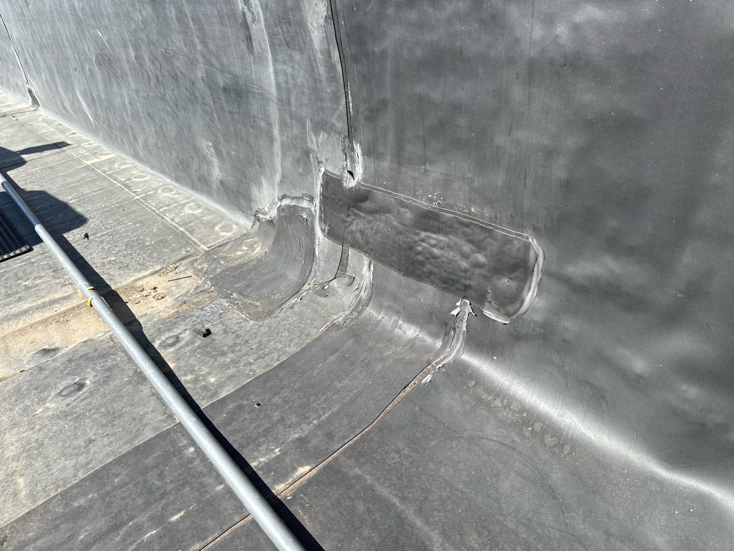

I just inspected a condo last week that had a balcony on part of the roof over the unit. I inspect all exterior surfaces that are adjacent to the unit, including attic spaces that are over the unit. The only time I don’t inspect the roof is if there is a unit over the unit I’m inspecting.
I also charge the same to inspect a condo as I do a single-family home. Sometimes it can be a challenge and time consuming to figure out which condenser unit, disconnect, and gas meter belongs to the unit I’m inspecting.
How sturdy was that railing? Did you climb them? Hard to resist :slight_smile:
“Chicken wire”! Did they have pets, or small kids?
The railings were sturdy, but being that they were climbable they did get written up as a potential safety defect. :+1:
I don’t know, the unit was vacant.
