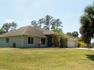

This roof incorporates the use of 3 tab shingles and has a 5:12 pitch. It seems to be in good condition, shows no signs of fastener or seal strip failure.

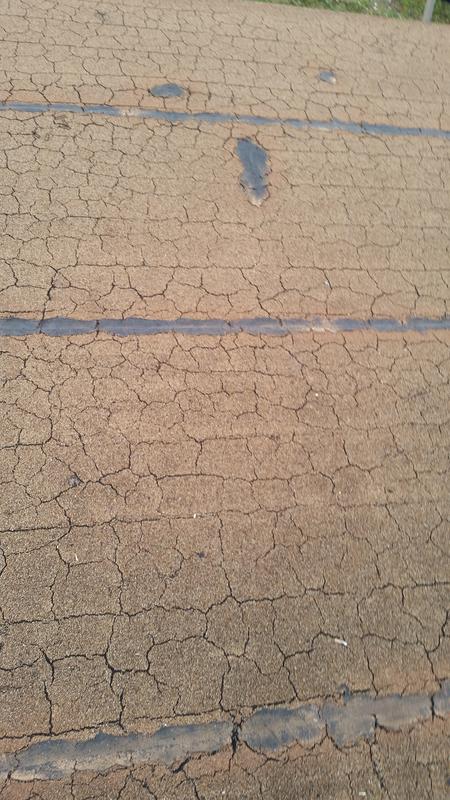

This is a picture of rolled roofing on a back porch. Significant cracking exists throughout the roof, evidence of patchwork, and biological growth in some spots. The underside of the roof shows signs of past leakage.
