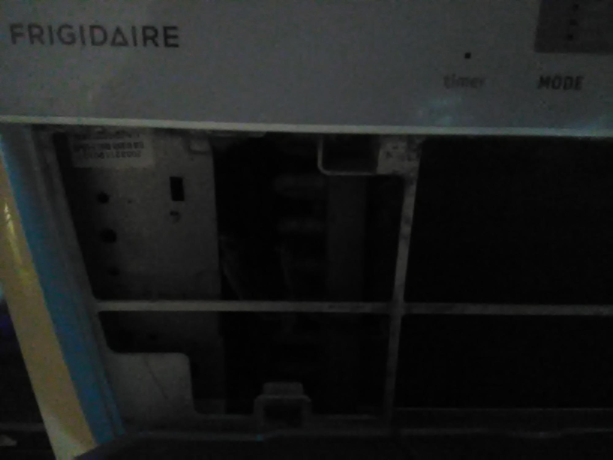

Condensing coil . On a window A/C unit . Unit seem to be in normal condition filter needs cleaning , this is done by simply running through clean water. This unit happens to be a Frigaire model 3speeds with a auto & econ mode setting . Also a cut -off timer . A/C only &fan

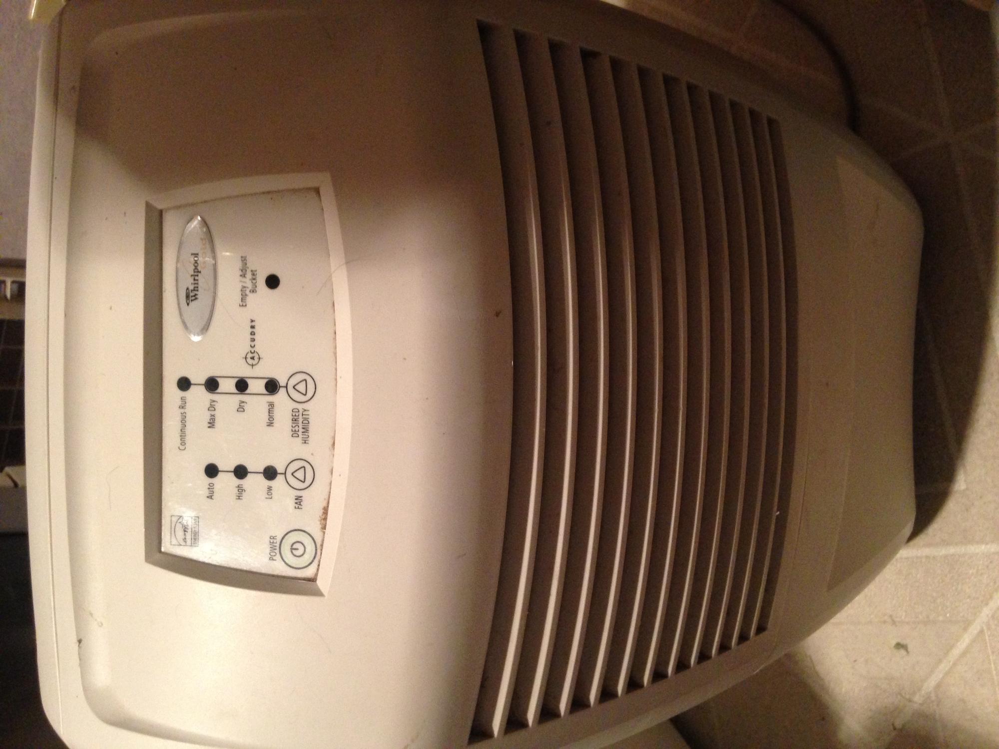

This Whirlpool Portable Dehumidifier is being used in the laundry room in this home. The laundry room is the greatest source of moisture introduced into this home. There are many children. The wet towels from nightly showers are enough to cause issues with heightened humidity. This particular unit has done a very good job at mitigating any moisture issues. The unit is about 10 years old and is in very good condition. Prior to utilizing the dehumidifier, there were occasional small patches of mold that appeared when items were stored on top of the cabinets and placed too close to the ceiling. Controls on the unit include three fan modes of low, high, and auto. There are four modes of normal, dry, max dry, and continuous run to regulate the level of dehumidification. There is a power button and an automatic shut down feature for when the reservoir tank is full of water and needs to be emptied.
So this relates to a Commercial HVAC System HOW???
Although this is a residential unit the same thing can happen to commercial units. The compressor and condenser line were frozen due to dirty coils causing inadequate airflow. This is why it is important to change air filters every 30 - 90 days depending on the type of filter, along with regular maintenance. What isn’t shown here is that the condenser line was running in the attic (line was frozen). Hot attic plus ice melting will cause water damage to the surrounding materials. Happy Inspecting everyone.
