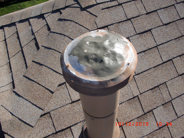

The inspection of an HVAC system should include the combustion gas ventilation. I find that the majority of the systems inspected by licensed HVAC contractors do not include the climbing of the roof for the inspection of the combustion gas flue and rain cap.
A picture with this writing assignment is of the rain cap of a combustion gas flue that has been damaged from hail. The damage did not allow complete ventilation of combustion gases. A receipt from a licensed HVAC contractor was on the kitchen counter, proudly displayed by the owner, as having the furnace addressed before my inspection.

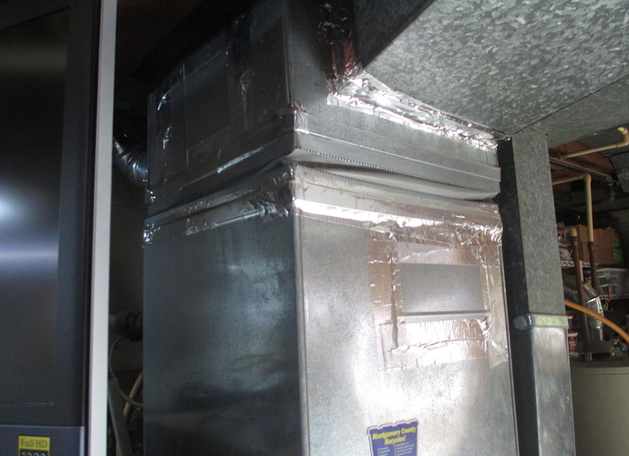

The third picture is of a furnace with metal tape sealing the joints. The tape looks fairly new, while the ducts look original to the house. The original install was most likely left with several gaps that lost heat and A/C from the supply ducts.
