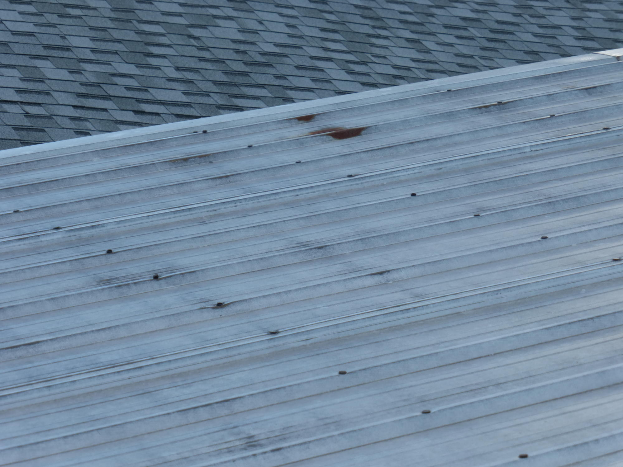

This image of a Galvalume metal panel roof was taken at a recent inspection conducted on October 28, 2015. The roofing had sustained what the inspector deemed “minor hail damage” , and this was reported in the inspection report for the buyers as follows : "Hail damage (cosmetic damage)
At the time of the inspection, the metal roofing had damage visible that appeared to be hail damage. This damage appears to be cosmetic only. We typically recommend a roof examination by a qualified roofing contractor, who can further evaluate the condition seen, if concerned.

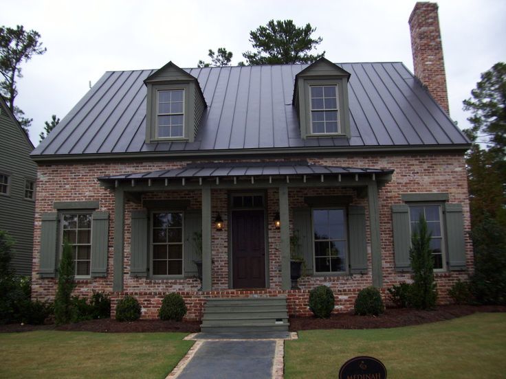

A steel roof inspection I did a while back had a couple recommendations made.
I know that when I see a steel roof, professionally installed recently, my tendency is to relax a bit so I force myself to observe every detail…
Like a new home…they do have their defects…
1975 split level…
The roof coverings are newer and appear to be in generally good condition. The installation of the roofing materials has been performed
in a professional manner. The quality of the installation is above average. Better than average quality materials have been employed as
roof coverings.
Flashings
Repair: Incomplete kick-out flashing can allow water to miss the gutter and soak roof/wall/fascia transition. Rear porch area.
Repair: One small segment of flashing is missing its screws. Rear deck Southwest corner.
Further evaluation by a licensed roofer is recommended.
That’s all,Bill O
