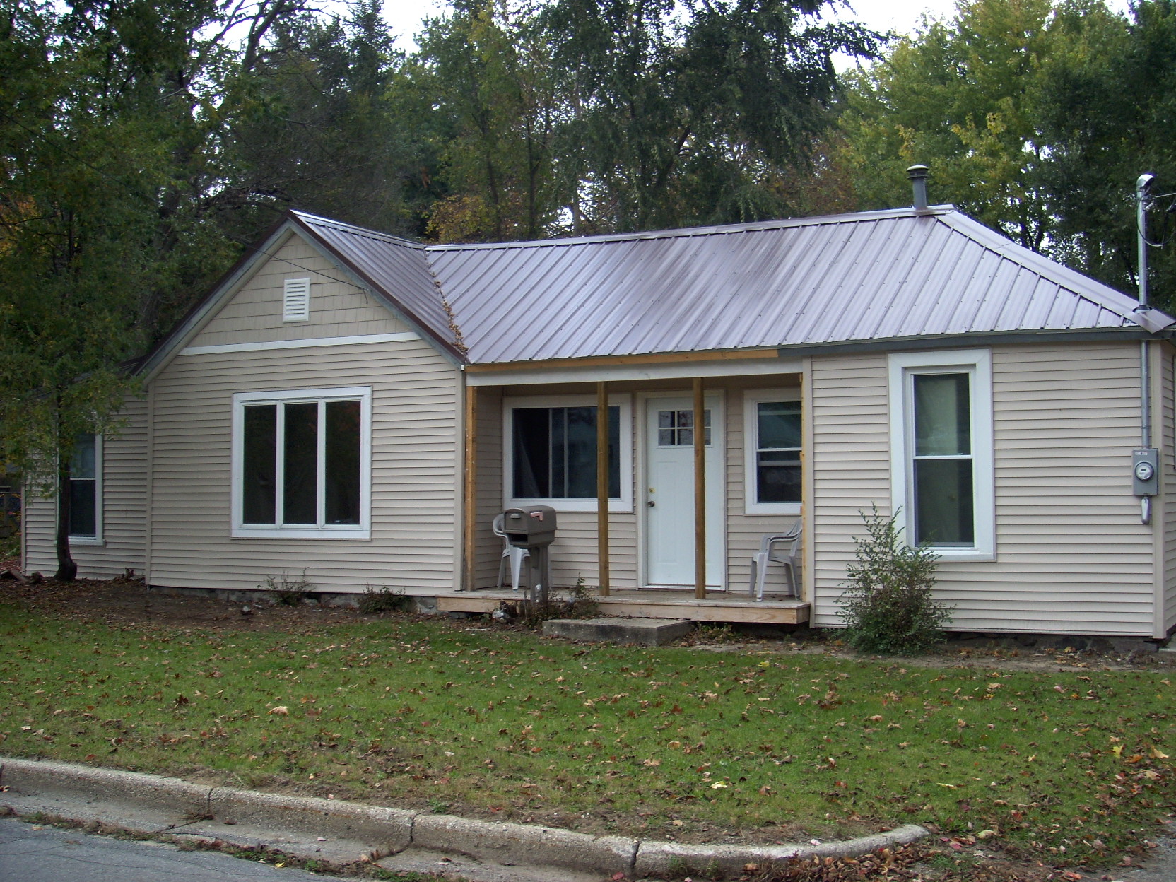

This is a metal roof on a small house next to the beach Pacific ocean.
There is some fading of the color.
This roof appears serviceable.

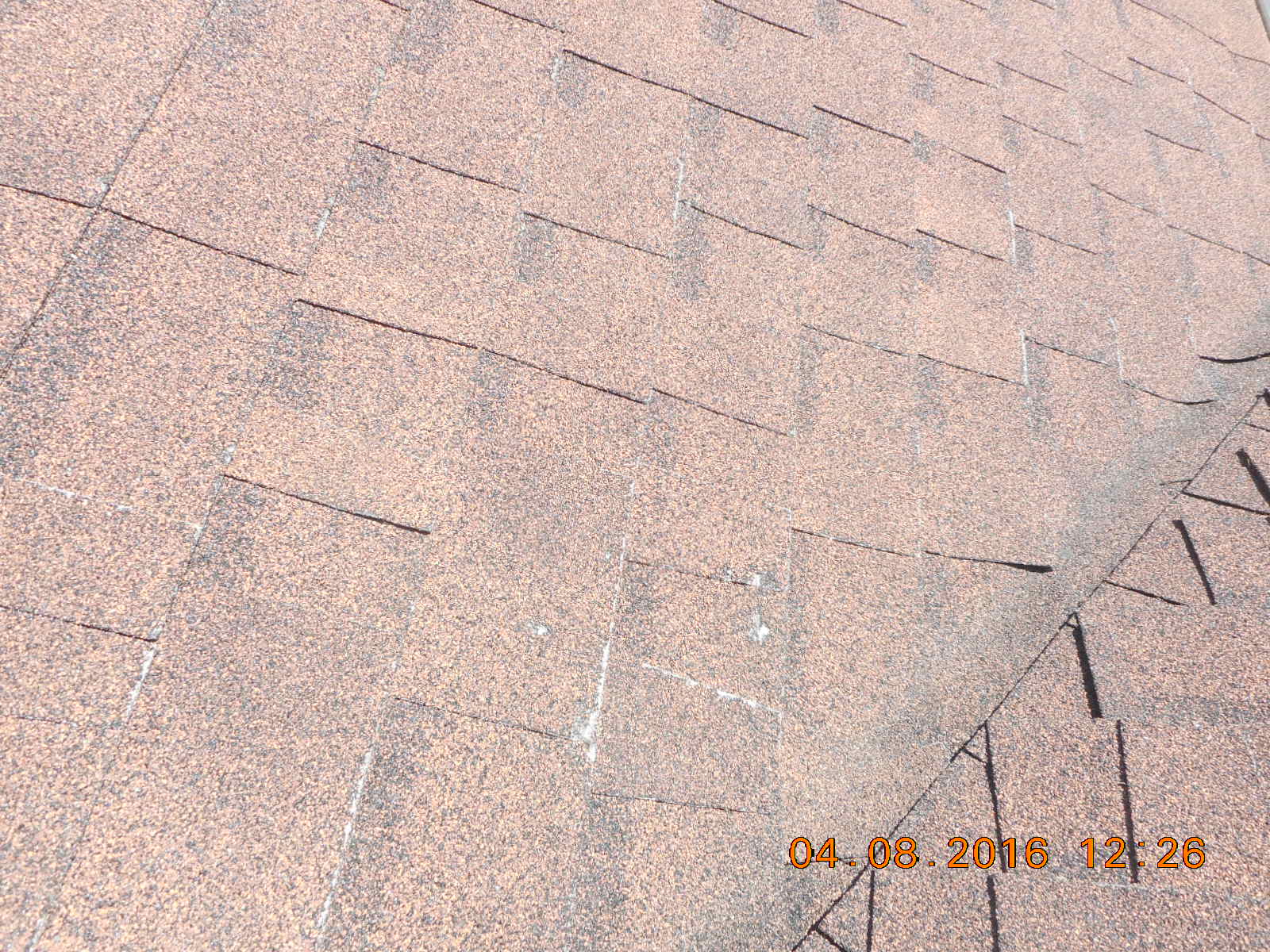

Essay on inspecting metal roofs. I didn’t have a metal roof to inspect, so I loaded a picture of a shingle roof.
This picture shows the deterioration of a shingle roof that is reaching the end of it’s life span. The granules are starting to wear off the leading edges, leaving the asphalt and fibers exposed. Without the granule protection, the shingles will be exposed the UV rays of the sun and deterioration will accelerate.
