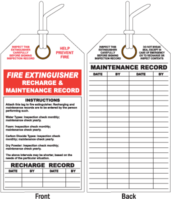

Watched video had no idea about monthly visual inspection so wonder how often it gets practiced.
Here is one from two days ago as I always photo and notate tags at every building inspection.
This info goes under the section of my report titled “Common Areas”
You will notice the tag expires one year after the year printed on the tag and the punch hole which contains the month.
