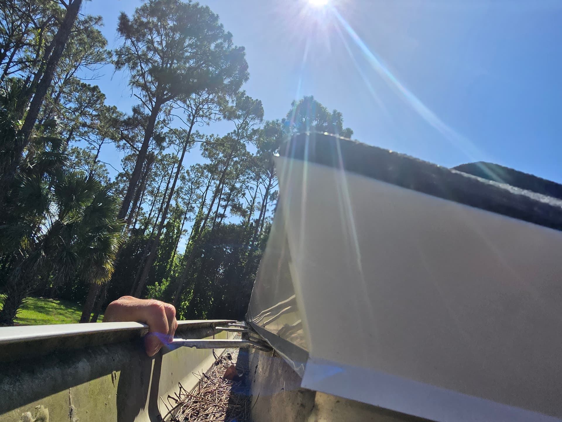

Hey everyone, I ran into an issue on a roof’s drip edge. All the corners are cut like this on a brand new roof. Has anyone ever seen drip edge flashing corners cut this way? Is this standard practice or should it be a concern? Just trying to figure out if this is normal or a mistake. See attached photo. Location Florida.
 ![20250728_143515](https://global.discourse-cdn.com/internachi/original/4X/0/0/0/000806a0fea61477b97c44b54ce0ca794d919b89.jpeg)

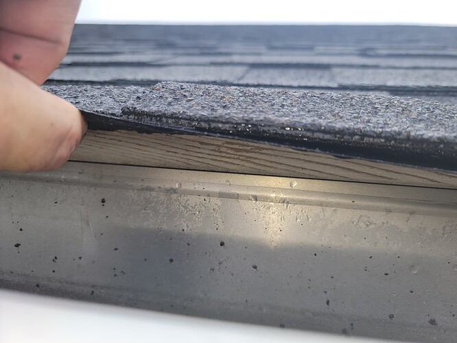

Here’s a picture of missing drip edge that I found on a recent inspection.
 ![Phone3d_30721](https://global.discourse-cdn.com/internachi/original/4X/2/3/b/23bdd1d4bcd188675f8021338ef7f915794a6f06.jpeg)

> [@tcathcart](#):
Do you have a picture from further back?

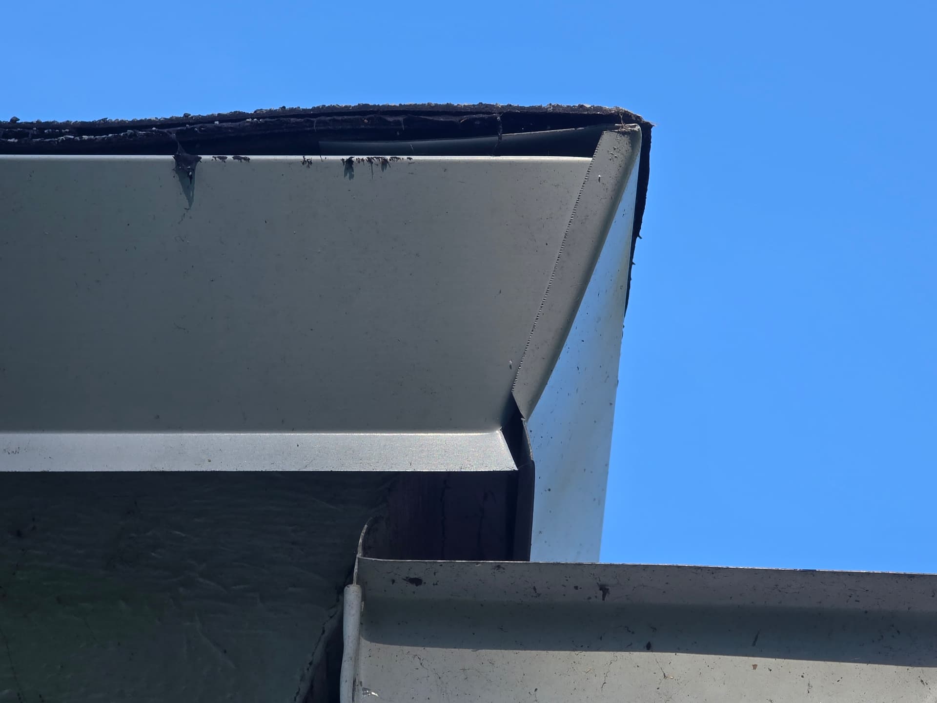

**Author:** ![tcathcart](https://sea2.discourse-cdn.com/internachi/user_avatar/forum.nachi.org/tcathcart/32/253822_2.png) [@tcathcart](https://forum.nachi.org/u/tcathcart)\
**Post date:** [July 28, 2025, 8:37pm UTC](https://forum.nachi.org/t/inspecting-roof-drip-edge/246486/18 "2025-07-28T20:37:53Z")
</div>
![20250728_163509](https://global.discourse-cdn.com/internachi/original/4X/4/2/0/420e02ae3595cbcd91b71b1568287af4b58cbb7a.jpeg)
<div class="post-metadata">
**Post date:** [July 28, 2025, 8:38pm UTC](https://forum.nachi.org/t/inspecting-roof-drip-edge/246486/19 "2025-07-28T20:38:38Z")
</div>
here’s another corner same thing better pictures
 ![20250728_163604](https://global.discourse-cdn.com/internachi/original/4X/f/3/6/f3663584a752832a38306eaa76a6863bd905b404.jpeg)
 ![20250728_163608](https://global.discourse-cdn.com/internachi/original/4X/9/4/4/9448d02d8438dcc6d892222177054ac045daf567.jpeg)
**Post date:** [July 28, 2025, 8:44pm UTC](https://forum.nachi.org/t/inspecting-roof-drip-edge/246486/20 "2025-07-28T20:44:20Z")
</div>
Thanks for your response, Kevin. I’ve attached a couple more pictures same roof, just different corners. Appreciate any insight you can offer.
