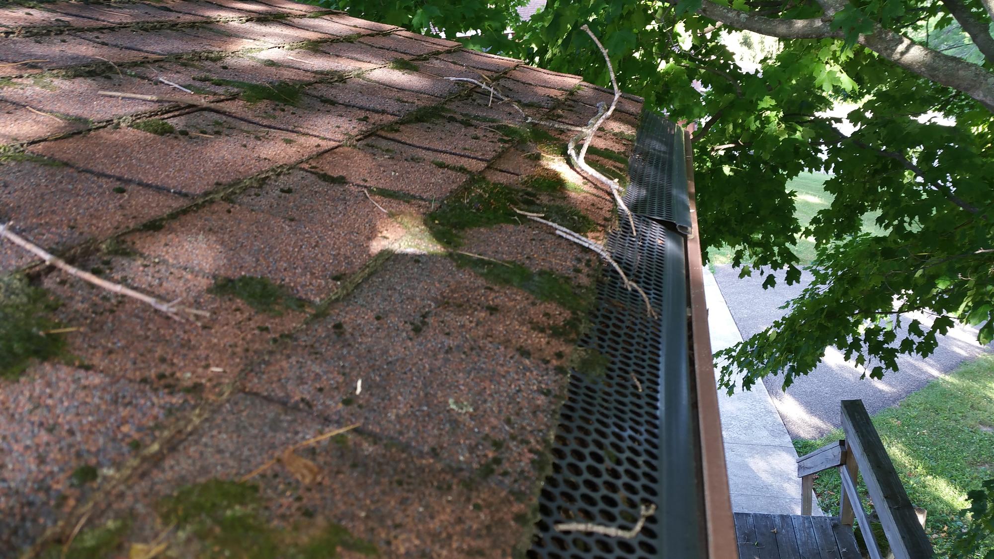

Tree branches are in contact and close proximity to roof covering and gutters. Vegetative growth was observed. Recommend trimming tree branches, clearing gutters, removing growth, and implementing normal gutter and trimming maintenance schedule.
