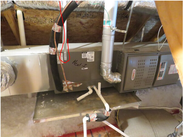

A5. The system is being suspended by metal straps attached to the rafters and the evap coil access cover. The evap coil case is no longer safely accessible without removing the strap which can destabilize the unit. There were better places to strap to and Lennox might even offer horizontal suspension kits to prevent this similar to their 51W10 Horizontal Suspension Kit for their heater/air handler units. Also don’t forget to write up those bare straps. Those things can cut you up pretty good! In our area most filters are located at the unit so make sure your clients are aware of that.

Here this is a very common issue that I see on about 70%+ of the units suspended with straps. It all comes down to installing as quickly and inexpensively as possible.
Sadly on existing homes that have been around for years you can tell they never entered that coil case as the pookie and/or tape is so old. I’m sure those are some nasty coils once they open them usually to replace them since they were never maintained!
