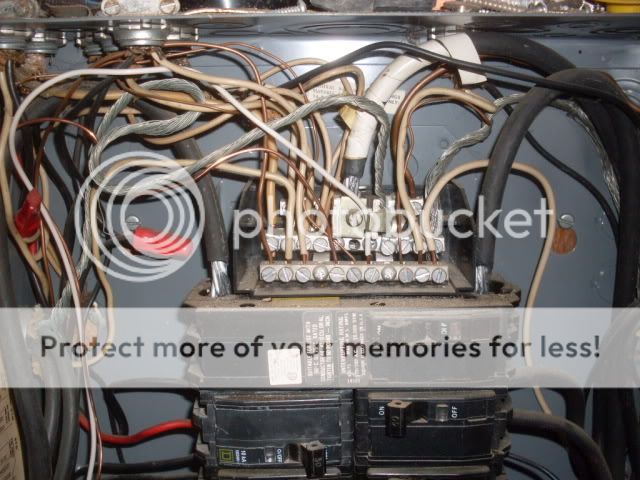

I agree Mike, and the point that I have been trying to make here is that in using my own house as an example, the 18 gauge ground wires are cut back and were never tied in to the metal box. So in this case, there is no ground at all.

Is that disconnect 18 gauge connected at the service panel?
I’ll post a picture later Mike, thanks. :slight_smile:
Marcel, you have no way of knowing if evey component of the electrical system is properly bonded to the grounding system without an evasive inspection. You can only report what you see and recommend accordingly. Using the example that we have been talking about all along, you need to say that the electrical system is grounded and the receptacles are of the non-grounding type. You can perform your CYA by making sure that every client knows that this is a non-invasive inspection ans you cannot see inside the walls, outlet boxes, ect.:cool:

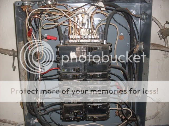

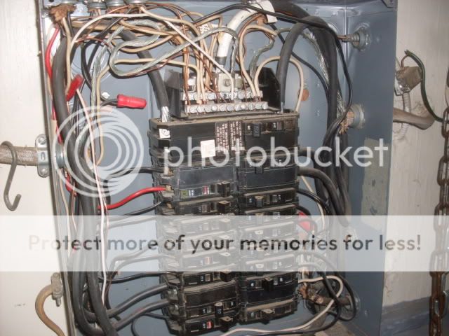

OK, here is the mess I have. They should have fired this electician in the 60’s that wired my house.
If you look close, most of the grounds are 18 gauge and a lot of them are cut off.
Some of the grounds that are 12 or 14 gauge is added.
http://i373.photobucket.com/albums/oo171/mcyr/SDC11978.jpg
http://i373.photobucket.com/albums/oo171/mcyr/SDC11979.jpg
http://i373.photobucket.com/albums/oo171/mcyr/SDC11980.jpg
Comments;:slight_smile:

Since I am hearing that a two prong system is grounded that I don’t agree with due to the pictures I posted, it appears no matter what I would report is in error.
As with most dwellings, that have been sloppyly wired like mine, the outlets are most likely to not be grounded period.
Therefore, I believe we should note that there is a possibility that due to the two prong outlets observed, a grounded connection for the safety of the client might not be existing and an electrical contractor should evaluate.
