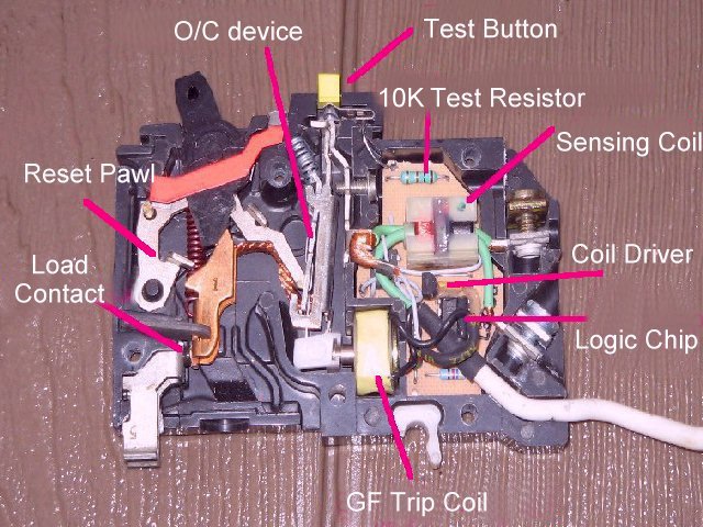

The QO GFCI I took apart was using a 10k resistor to trip it with the test button. That is quite a bit above 5ma (12 or so)
The QO GFCI I took apart seems to be using 10k to trip it with the test. That is 12ma

BTW Mike the QO GFCI seems to be tested at the 12ma level, not 6
