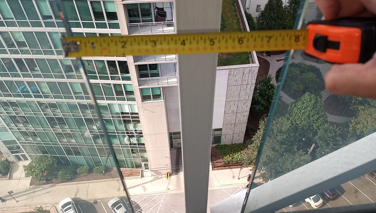

This feels wrong to me, somehow, though having a hard time finding a specific defect. Roughly 4 inch gaps in glass railing. Not large enough to flag for insufficient infill, but still pretty big, given there’s a 12-story fall. Does anyone know if there are different requirements for high rise balconies? I couldn’t find anything in my AHJ (Chicago). Looking for some general info, if possible. Thanks.
Do children’s heads get smaller the higher up they are?
Probably bigger along with their ego’s :sunglasses:
