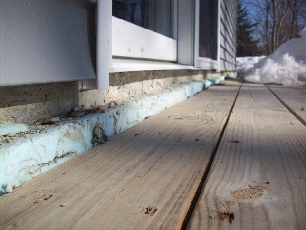

yesterdays inspection has an exposed area of the exterior slab, insulation cut short… and it is melting the snow away from the home… heat loss? :roll:

Is that 1" of foam insulation showing above grade? I hope that its not the slab protruding out from under the siding.
2" rigid foam insulation that is not flush with the top of the slab… i will try to post another angle…
here is a different angle… and yes… no support for the door sill
