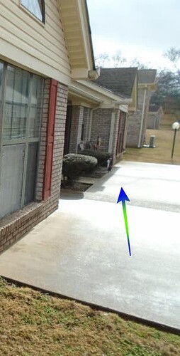

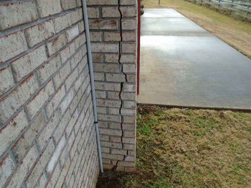

1996 single story apartment on slab Alabama. Does not look like settlement per se. Brick footing was cracked as well where visible (about 1.5 inches in view). Any ideas on the cause? For edification purposes, writing the narrative is not the issue.

That is interesting, considering the crack is the same size all the way through, and no offset.
<div class="post-metadata">
**Post date:** [January 18, 2023, 3:18am UTC](https://forum.nachi.org/t/interesting-brick-veneer-cracking-comments-needed-please/224619/3 "2023-01-18T03:18:37Z")
</div>
> [@dhorton2](#):
> and no offset…
Bingo…like a truck was backed into it (from the inside) 😁

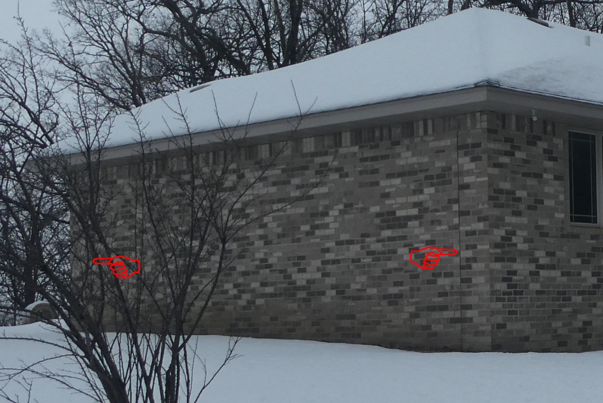

Redneck expansion joint??

Not sure what would causation would be without more info.
- What is **under** the brick?
- Expansive soil?
- Any other areas of cracking?
- Has the subgrade slid towards the low lying area towards the fence?
- Any separation of the wood trim at the top of the brick? Behind the conduit maybe?
- Does a Sumo Wrestler live there??
The crack appears to follow the grout line at the top course back to the corner and is inconsistent at the soil level. There’s got to be more to it…
**Post date:** [January 18, 2023, 4:20am UTC](https://forum.nachi.org/t/interesting-brick-veneer-cracking-comments-needed-please/224619/6 "2023-01-18T04:20:59Z")
</div>
- What is **under** the brick? I do not know. I can see a about 1.5 inches of footer
- Expansive soil? Wouldn’t know it if saw it. Poor site drainage for sure though.
- Any other areas of cracking? At various other units, yes. Nothing like this but some interesting finds. I’ll throw in a few pics
- Has the subgrade slid towards the low lying area towards the fence? That patio is stationary IMO
- Any separation of the wood trim at the top of the brick? Behind the conduit maybe? Crack goes behind the frieze, but the trim is intact.
The crack appears to follow the grout line at the top course back to the corner and is inconsistent at the soil level. There’s got to be more to it…Agreed!

> [@bcawhern1](#):
Just a couple of thoughts:
Is there a footer under that part of the wall, or did they just pour a base for the brick wall?
Did the crack transfer to the slab on the inside?
**Post date:** [January 18, 2023, 1:13pm UTC](https://forum.nachi.org/t/interesting-brick-veneer-cracking-comments-needed-please/224619/8 "2023-01-18T13:13:59Z")
</div>
Hi Richard.
The owner stated the brick footing is separate from the slab. I could not verify.
I did not have access to the interior of this unit. So, we’re flying blind.

It sure looks like the edge of the slab broke and slipped. The crack in the brick looks clean indicating that it may be fairly recent movement. Definitely a call out for further evaluation.
