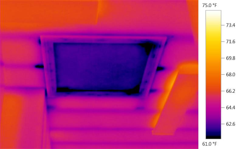

You might find a leak or two in a log home using infrared, if you know how to look.

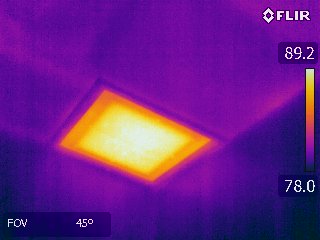

Here is a doorway from my last job.
That an attic hatch ?
Here is an attic hatch :smiley:
Attic hatch down here
