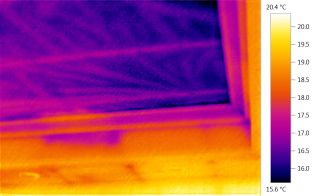

Recently found a spot about 9 sq.ft. where the attic insulation had been blown away by wind. It was hidden from view at the attic hatch. It being -20C outside that day with high winds it showed up clear as day. Ceiling temp was close to freezing.
Never would have seen it without the IR.

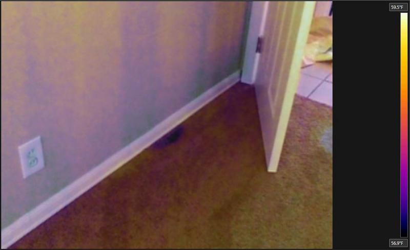

these are always expensive… water coming up from below carpet at walls opposite shower pans… look at the delta T I was working with, it’s my opinion that this is where the less sensitive/lower res cameras would have little chance. Absolutely no water marks… pan had been flooded and tested/cleared by pest control operator earlier. There are soooo many others like this, I couldn’t begin to count, happened to have the images as it was recent (I don’t save everything)
Images are mine/copyright etc… ask first :smiley:
