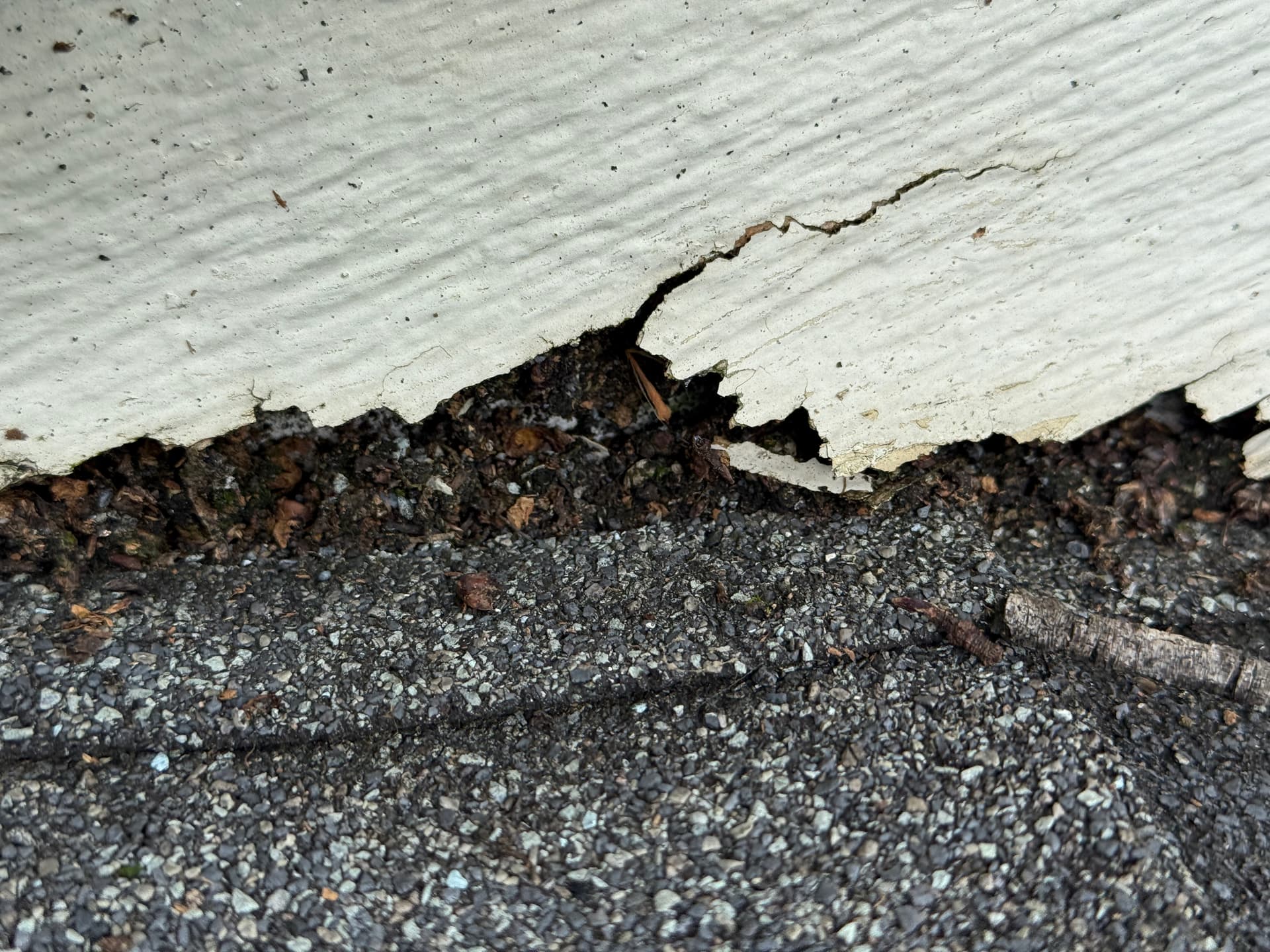

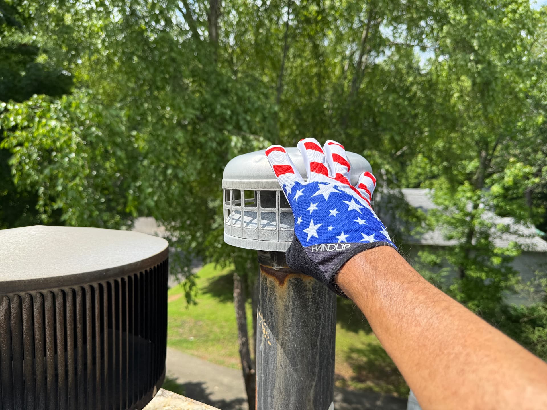

Would you see this from 50 ft away?
Rotten Masonite (hardboard) siding

Loose exhaust vent

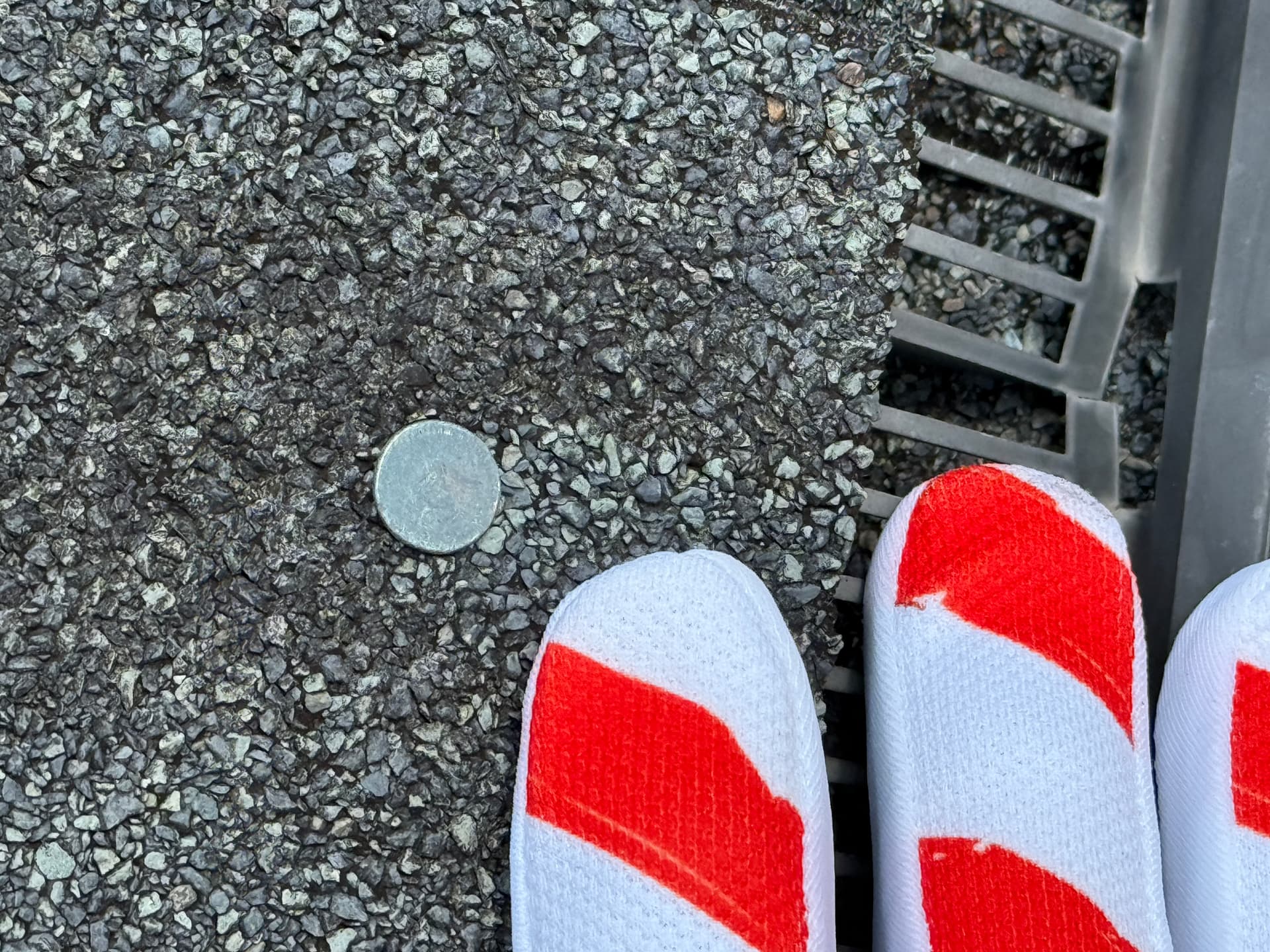

I took a course in drone photogrammetry with the intent of doing some aerial surveying. While very interesting, it didn’t really apply to home inspections. I fly a bulky Mavic 2 with a zoom lens. It can tell you whether or not the dime you throw up on the roof is heads or tails and if the light is right it can tell you the date. All that to say I really good detailed, close-in photos with it. Like everyone else says, climbing onto to roof is always the best option as nothing beats being able to put your hands on it. But if you have to use a drone, do it manually.
