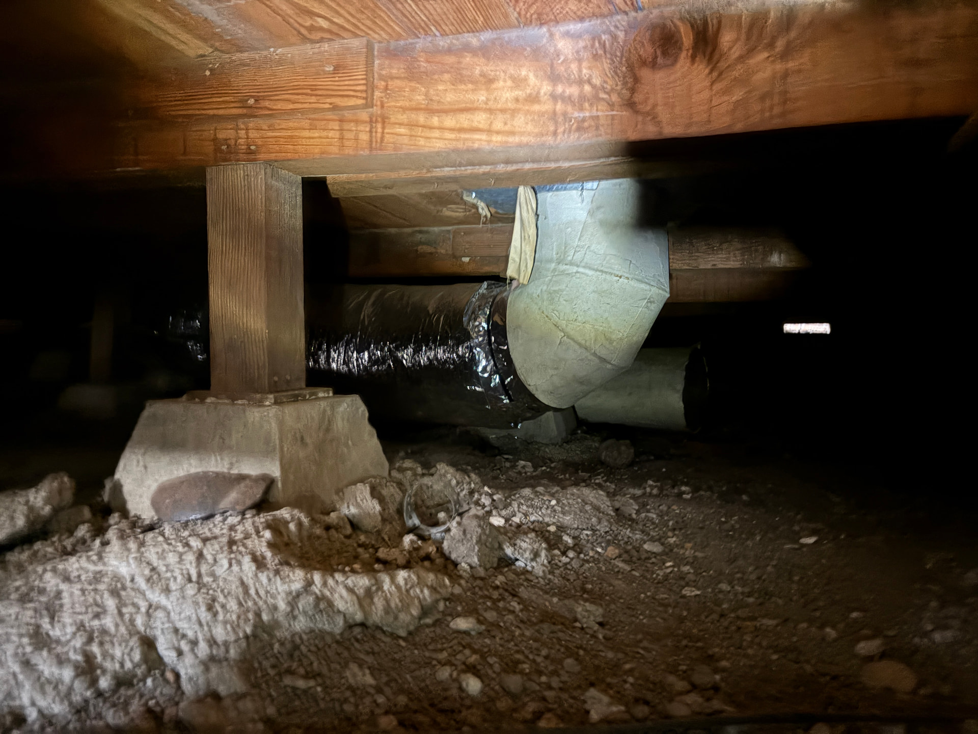

Is it necessary to have T tie metal connecting floor girder and support posts? I inspected a crawlspace and the floor girders beam just sit on top of the wood posts and are only toe-nailed, should I recommend home owner to add T tie to secure the girders and posts for seismic concern in San Francisco Bay Area CA. As more and more buyers are flagging this. If we leave it as-is, it will almost certainly show up on the inspection report as “recommended seismic upgrade” and the buyer will ask for a credit or for it to be fixed before closing. Please share your thoughts, Thank you.

Thanks for your feedback. Here is the picture of girder and post without any reinforcement hardware

Looks like older construction and “T-ties” or gussets, as they’re usually called, weren’t standard. It’s not a bad thing to mention but realize how many other changes there have been since then and how many of those you’re NOT mentioning.

To answer your question. It is advisable to observe manufactured mechanical fasteners, easier to see, but not necessarily so. As long as structural connections are properly secured manufactured mechanical fasteners are not required, although highly advised when erecting.
What you are referring to is a manufactured mechanical fasteners. ([Heavy T Strap] Simpson Strong Tie(https://www.strongtie.com/shapes_specialtystraps/htq_strap/p/htq))
The wood column appears toenailed fastened, toenailing is a standard construction method that involves driving nails at an angle to create a strong, angled connection, commonly used for framing members like studs to plates or joists to beams, at the top and bottom to prevent rotation/rotating.
The footing is suspect for being a manufactured poured concrete pad, and not a required footing being below zone frost line, or generally 12 inches below the undisturbed ground surface when the frost line is shallower than 12".
The soil does not have a vapour barrier to prohibit soil moisture from migrating into the unconditioned crawl space.

I am sure toenailing is used to secure the beam on top of the post, but in CA, earthquakes happen more often than in other parts of the country. That’s why I was recommending T strap. Some home buyers may ask the seller to secure it or ask for a price cut. Your point is well taken about the 12" frost line.
