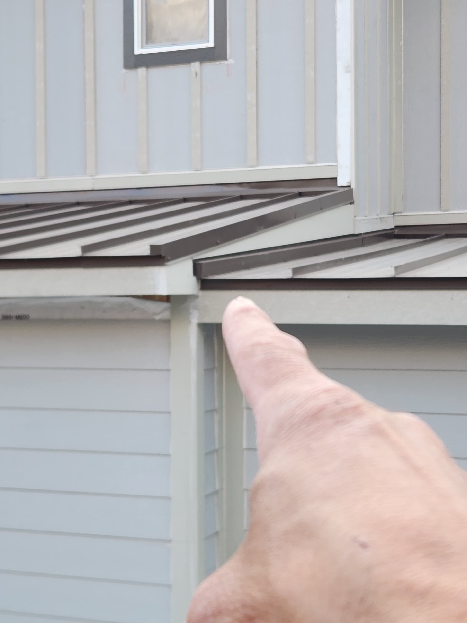

This is my own roof and the roofers said that movie flashing isn’t needed here what are your thoughts?
 ![20250612_193656](https://global.discourse-cdn.com/internachi/original/4X/a/b/9/ab91449551c291e9a2fd655514afbbc4fd81fd65.jpeg)
 ![20250612_193431](https://global.discourse-cdn.com/internachi/original/4X/d/2/5/d252bc88dc5b84722d46568f581be6781f6a55b7.jpeg)

Cory,
I would say yes. Better to error on the side of caution and list it as needs further evaluation. Hard to tell if there is guttering; if there is, then the kick out will insure water flow into the guttering and not along the exterior wall surface. Hope this helps.

The gutters are off right now but there are gutters.
Here’s more pics
 ![20250612_201420](https://global.discourse-cdn.com/internachi/original/4X/9/1/c/91ce859ab490ab5b7aa0b6ad20f88cf01c5b186d.jpeg)
 ![20250612_201426](https://global.discourse-cdn.com/internachi/original/4X/2/5/d/25dfbfa9dba559da3d772a0d2c0ff33413496067.jpeg)
 ![20250612_201428](https://global.discourse-cdn.com/internachi/original/4X/6/2/9/62978cdd38655e1d8a5ae6c3ec9156c3dbe127c9.jpeg)

I don’t know if it’s necessarily a kick out that is needed, but something is needed to get that closed up a bit better, in my opinion. Although it’s not easy to tell exactly what’s going on based off the pics.

Water is going to flow into that open area. Kickout/diverter flashing will direct it into the gutter. That open area needs to be addressed to keep water out.

We can see, keep the fingers out of the way! SMH 🙂
If it were my home, I would 100% install kick-out flashing.

I know i misjudged the coverage of the flashing. Now i get to cut a new piece of siding. Pain in the butt to cut that piece. Dang it.
But good catch.

Tell the roofer to come back and flash it properly.

It would certainly help to have rain gutters for kickout water to be channeled away from the home, not just the siding.
