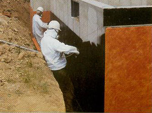

Is there anything code specific to water proofing or damp proofing a poured concrete foundation.
I see two different methods around here -
One being just the spray on rubberized asphalt with the drain strip at the base - then backfilled.
 ![IMG_7538.jpg](https://global.discourse-cdn.com/internachi/original/2X/a/a1c8e50fb4d007037a93780a116a5f18e0273898.jpeg)
Second one is the same as above except immediately after the asphalt is sprayed, sheets of rigid fiberglass are placed on the asphalt -then backfilled. ![waterproofpic1.jpg](https://global.discourse-cdn.com/internachi/original/2X/f/fd555ab636e7f27d287b7a452116ec702e77cbae.jpeg)
Anyone have any comments on the pros or cons of the above applications? I couldn’t find any code related to water proofing a poured concrete foundation, but I’m sure it’s out there.

Dampproofing is required by code. Waterproofing is not.

My 2 cents…NEITHER of those pics is WATERPROOFING.

a) damproofing (tar only) is not waterproofing
b) drain clad (reddish or yellow FIBERGLASS boards) is not waterproofing \<-----------------
c) system platon(heavy black plastic mats with bumps on one side) is not waterproofing
refers to following as frauds…got MILK? Well do ya :mrgreen:
d) water control is not waterproofing
e) a sub drain system is not waterproofing
f) bentonite injection is not waterproofing
g) a pressure relief system is not waterproofing
ummm, INSIDE SYSTEMS ain`t freakin waterproofing.
