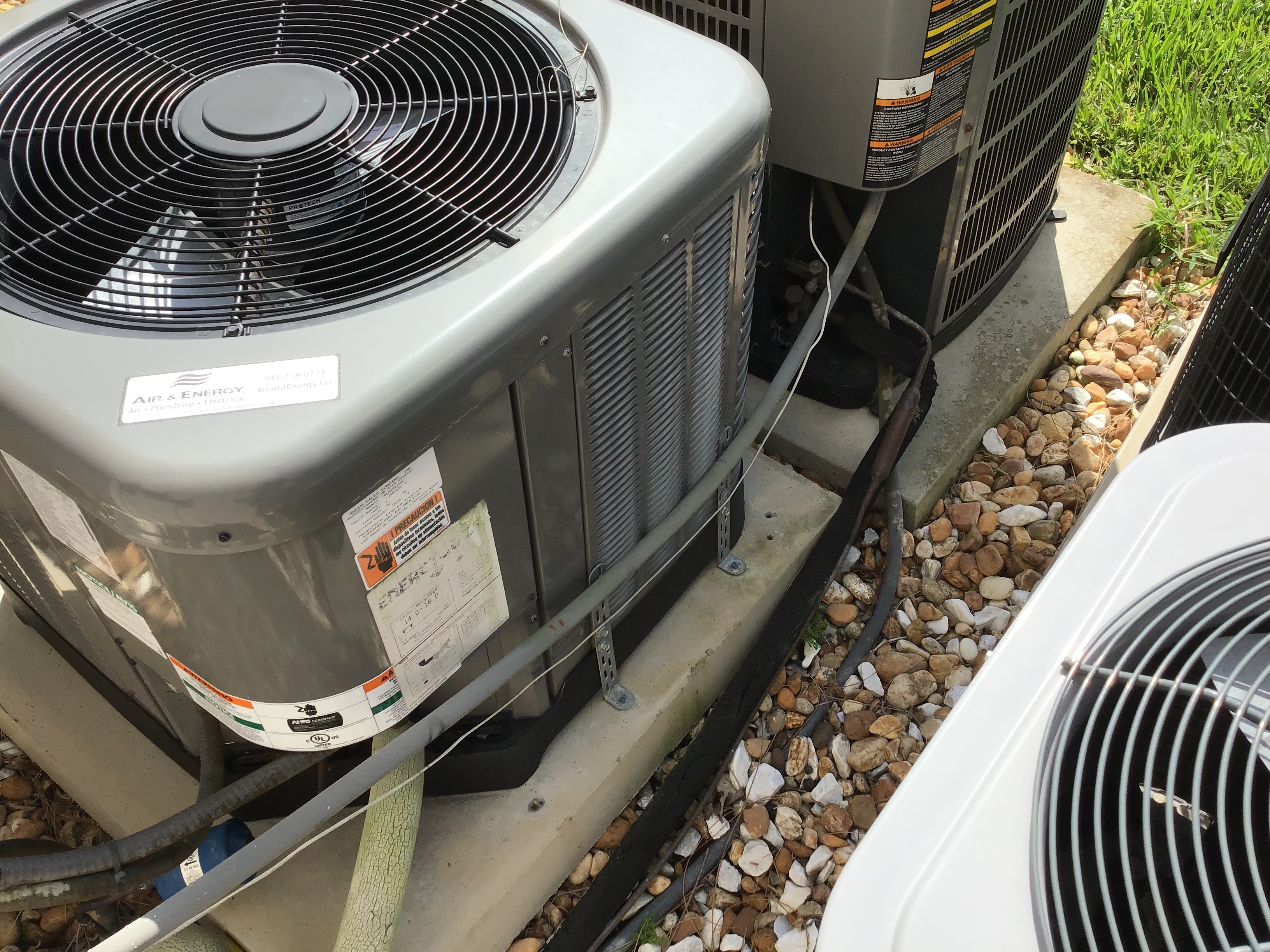

Is this A/C whip exposed to damage?
Does the whip going to the outer condenser violate UL 360 or 1660 standard requirement that it be protected from damage, or something in the code? It looks to me as if work on the inner unit could put a strain on the whip’s terminations and create a possible electrocution hazard. Any thoughts?
Nah, they’re professionals. :smile:
As always, all conduit should be supported at some interval. The liquid tight flexible metallic conduit shown in your photo should be supported as per NEC specifications and should also be located such that they are not in an area where they are walked on or subjected to other potential damage (e.g., water, lawn mowers, weed eaters, foot traffic). UV damaged items should be replaced.
Why are there two electrical conduits running to each of the units? Have never seen that in my area
You’re missing the obvious on top of improper routing that the conduit is blocking access to the other unit for maintenance.
One is being used for the electrical power and the other is being used for the thermostat control wiring (for protection)
I would be concerned with the clearance between the AC compressor units.
12” or more of clearance is usually recommended.
Are the brackets attaching the unit to the pad ( closer of the two units to the camera) common in your area? I haven’t seen those used in my area and I’d be hesitant to have those sheet metal screws driven so close to the coil. Thanks!
Code required in Florida, and they even require the bracket to be rated, listed and approved. Never seen the screws damage the coil yet…
Thanks Dominic!
It would take more pictures to be sure but I suspect that one or more of the compressor units is in violation of the general clearance requirements of the US National Electric Code.
110.26 Spaces About Electrical Equipment. Access and working space shall be provided and maintained about all electrical equipment to permit ready and safe operation and maintenance of such equipment.
