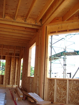

I am building a home here in Japan. The home is basically a Viceroy home being imported from Canada. The home is partial prefabricated and it seems to be well built but one thing is troubling me. The pictures below are of a beam in the first floor ceiling(the house is two stories). It doesn’t seem to have much holding it up. I am not a carpeter or inspector and I pointed it out the the carpenters said they will reinforce the vertical post below the laminated beam. They will add a few 2x4’s to the wall below where the laminated beams connect. Is this OK? Any opinions? For some better picture click here for my homepage.

What I’m wondering is what is the real question about the beam. Are you concerned with what it is made of? That it isn’t solid wood? The beam appears to be an engineered LVL beam. Generally meets standards in USA if properly sized.
No, I am concerned about whether or not the beam is being supported well. It seems to only have a small 2x4 wall under it but the beams are supporting a large part of the floor above them.

As for what I see in the pics, the “Timber Strand” beam or LVL has it’s load tranferred to the ends of the beam. Are there walls directly under 2x4 walls shown in pics?
The framing members carrying multiple joists are engineered lumber, as David said. Different kinds of engineered lumber are designed to be used in different situations (a microlam would be required in the US for the application shown in your photographs, Timberstrand would not work, as it’s only used in compression). You should find someone near you, an engineer, contractor or inspector to confirm that proper framing materials have been used.
There appear to be only two wall studs (2x4’s) carrying a sizable floor load. A structural engineer would need to determine the requirements for supporting the load. The fact that the wall top plate extends beneath the load-bearing beam may mean that the wall has not yet been completed. Sometimes during construction wall studs are left out temporarily to make it easier to move around in the house. Have you asked your framing contractor about your concerns?

Thanks for the comments. I have seen the plans and it appears that they were followed correctly. I have talked to my contractor and he seems to think it is OK but is willing to add some studs to help carry the load. Directly under the studs that are seen presently is the main mid beam of the first floor which rests directly on the concrete foundation. I also sent a email to Viceroy and included a link to my website. By the way are the photos Ok? Are any more angle or photos needed to see the situation more clearly?

I’m obviously not familiar with Japanese carpentry, but it does not look like they are done framing the wall yet. Whether or not it is supported depends on what is above and beneath the beam or bearing point. Nothing is a substitute for being there.

It wouldn’t cost much to stiffen the load carrying supports. Just ensure the beams carrying the weight of the studs mid span are also adequate. It may be necessary to add another column under the mid span of the beam. Inexpensive for piece of mind. Good luck.
But if this designed for an area of seismic activity, stiffening can actually reduce its ability to withstand the effects of an earthquake.
