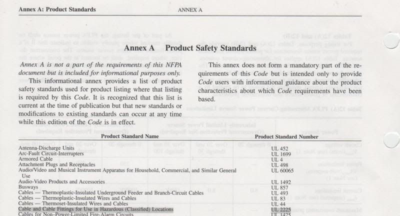

In a discussion with someone else about the UL Standards I came across this;
http://i3.photobucket.com/albums/y63/jwelectric/AnnexA1.jpg
The NEC itself makes the statement that the UL Standards is for information only and not enforceable
