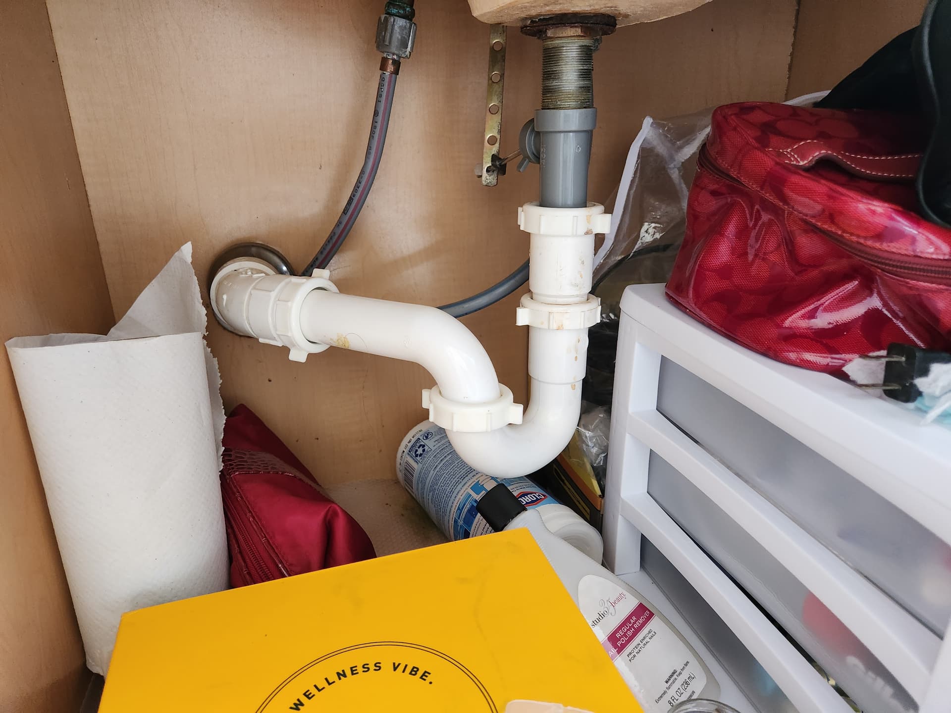

Hi, I am running to the same issue with the insurance agent mentioning that it was reported in the past as pex pipe and now I put it as poly. See attached
 ![20230303_102027](https://global.discourse-cdn.com/internachi/original/4X/b/4/7/b4708b2d2b2bffda0e22c9ffd86d8aedeb7a5cea.jpeg)
 ![20230303_102026](https://global.discourse-cdn.com/internachi/original/4X/c/7/d/c7d639d246bd7fb83e493d4d491c6bbcc23a4cdb.jpeg)
 ![20230303_102222](https://global.discourse-cdn.com/internachi/original/4X/1/f/8/1f87c3b2dd4331985a863ea82fa5b98ba91c0cd2.jpeg)
 ![20230303_102319](https://global.discourse-cdn.com/internachi/original/4X/d/9/3/d93a84ce169beaf975b5f31ed24966a4850bbfd1.jpeg)
How can we explain to them that gray pupes are poly?

First, PEX is a type of poly pipe. I would refer to it as PB (polybutylene), not simply poly.
It is PB because the markings say so right in your pic; it shows D-3309, a standard that was used to test PB pipe (tubing).

Not sure what year the home was built but if you cannot verify it is PB, then crafty words will give them the information they need.
The pipe is consistent with PB which was commonly used during the era this home was built. …Then talk about your concerns with PB and the need to be further evaluated by a qualified plumber in order to better understand risks and replacement cost if needed.

Maybe this will help. There’s enough information on that pipe for me to be comfortable calling this polybutylene tubing.

forgot to reply back and thank you, excelant.
