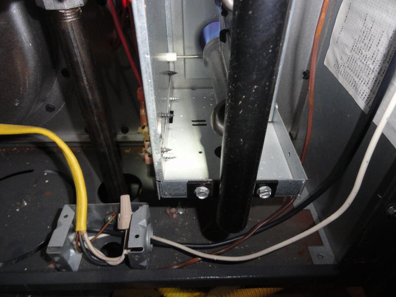

A 6 year old furnace. I was not sure if this was a small amount of rust. Would you be concerned?
 ![DSC03647.jpg](https://global.discourse-cdn.com/internachi/original/3X/e/4/e40f9651779cce84dd997e714f791a24cd5961e8.jpeg)

pic 2. a little better angle.
 ![DSC03648.jpg](https://global.discourse-cdn.com/internachi/original/3X/1/d/1d28f2f01d926352d630f670f02fcff8f4de268b.jpeg)

[FONT=Comic Sans MS]I personally would not be too concerned; it looks more like mild corrosion (electrochemical oxidation).

no worries…

tHANKS. Did not think so but just wanted to put it out there.

Not about the mild rust but about the piece of what appears to be 120V 14/2 wire (power supply?) resting on a sharp metal edge (no box connector) in an appliance that has vibration from fans/motors.
