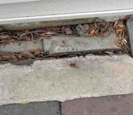

Rigid conduit from meter to service disconnect.
Is this pull elbow OK for “buried” use?
If not, code cite of possible, please.

It looks like an aluminum “LB” as opposed to being a malleble iron type. I wouldn’t want either one underground. The aluminum one will corrode very quickly in this application. NEC 300.6 Raceways, cable trays…fittings… shall be of materials suitable for the environment in which they are installed.
Here’s the other side of the meter, BTW:
That is called an LB fitting. Buried is not the trouble. The fact that the cover is not accessible is trouble.
**NEC 314.29 Boxes, Conduit Bodies, and Handhole Enclosures
***to Be Accessible. ***
*Boxes, conduit bodies, and handhole **enclosures shall be installed so that the wiring contained **in them can be rendered accessible without removing **any part of the building or, in underground circuits, without **excavating sidewalks, paving, earth, or other substance that **is to be used to establish the *finished grade.

Won’t it be accessible when the fitting completely corrodes away in the next couple of years?
Isn’t it prone to galvanic action with the soil which would be different than just being in a wet environment?

If it is okay to bury the LB, how can it ever be accessible?
If it was pointed downwards, cover facing up (for instance).
Even if burial has some deleterious effect on the LB (a topic on which there is some doubt), it is much easier to cite the more direct violation of the cover not being accessible. Either reason might make the installation “wrong”. One reason just has more clear text on the matter.

As far as I can remember it is not OK to bury a JB wether it be an LB, LR or a 4 square. I seem to remember that they all must be accesible to qualified personel. I would look it up, but I dont want to.
